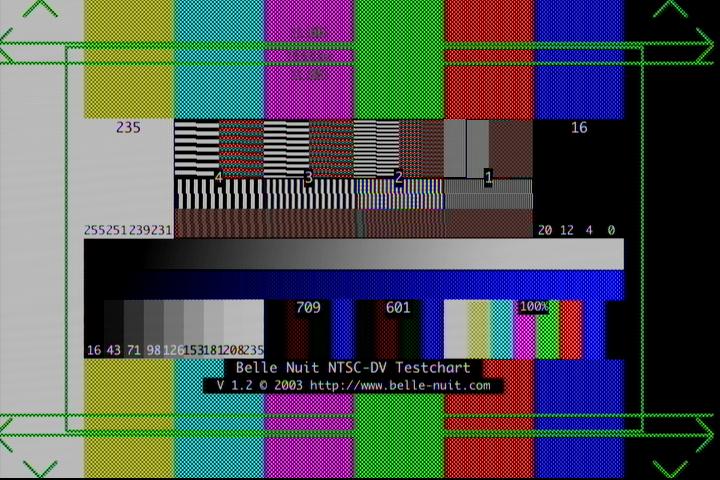

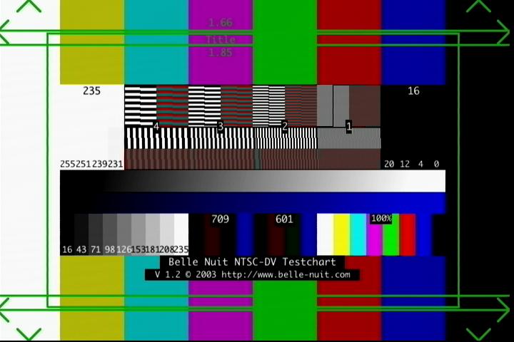

  4. S-video isn't always better. Some regular VHS decks had s-video connectors but used standard composite hardware at their core. They used a cheap trick to generate the s-video signals. This left the chroma sub-carrier in the luma signal. The result looked OK with low res CRT TVs but with a capture device you get severe dot crawl artifacts. You get something like this (be sure to view the images full size):
    instead of this:
    Just run a quick test with both and see which looks better. Use a very colorful video segment (cartoon?) as that is where the problem will be worst.
