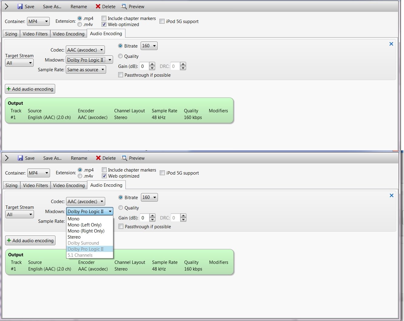

    My other concern is that vidcoder has the audio "mixdown" default to Dolby Pro Logic II. The other option are mono, stereo, dolby surround, 5.1 channel. Do I simply leave it as default pro logic II? Isn't pro logic II artificial enhancements of some sort to the soundtrack. The output files sounded perfectly fine with pro logic II through my set of generic radioshack wireless headphones and ipad pro's factory speakers.
    What's the preferred choice or does it not even matter when it comes to movies and tv sitcoms, and animations?
    Stereo
    5.1 chance
    dolby pro logic II

    Looks like there's some added bits of "audio information" with the Dolby Pro Logic II setting. I can hear the difference using my headphones. I remember back in the days when I use to have one of those AIWA stereo system with the cassette deck and cd player rolled up into one, putting on the dolby pro logic or whatever "audio enhancement" setting creating "artificial" audio playback, somewhat with an "echo" effect. It sounded cool but didn't sound natural to the original source material.
    I might have to either encode again using just the "stereo selection" and/or check the box that says "audio pass through" in vidcoder. I checked mediainfo and even though all the audio info looks exactly the same, it simply doesn't sound the same using the Dolby Pro Logic II selection. It sounds like there's extra "scratches" or whatever it's called.
    Just did a test run using ULTRAFAST video encoder and under the audio encoder setting using "stereo" and "audio pass through" in vidcoder, and now it sounds the same as the original file without that "echo" or "added dolby pro logic II" effect.
