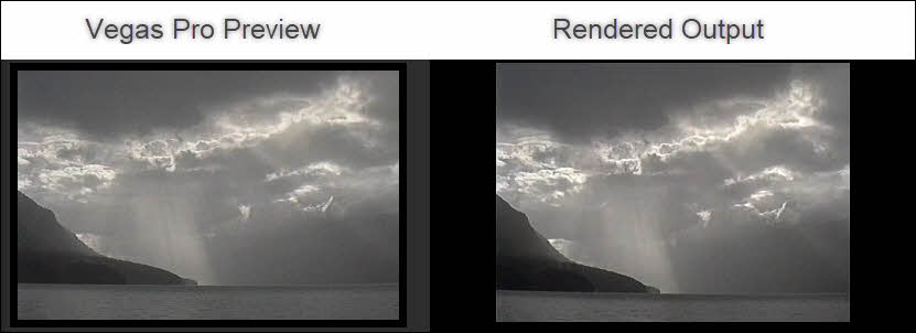

    Here is a side by side of my Vegas Pro preview, and the rendered video:
    [Attachment 44664 - Click to enlarge]

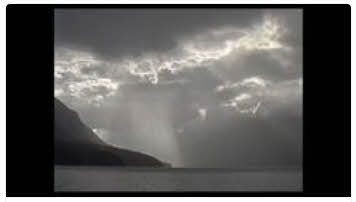

    And what it looks like in the 16:9 (1280 x 720) format on my Vimeo page:
    [Attachment 44665 - Click to enlarge]

  3. Vegas' preview looks wider . The island looks "fatter" and taller in the output pic compared to vegas. Normally you would resize to 960x720 (which is 4:3 exactly), then add borders 160 to each of left, right
    Thanks poisondethray. For resizing, do your recommend I do that in Vegas before exporting through Frameserver? Or resize to 960x720 via MeGui, then add the 160 borders, and then resize again to 1280x720?
  6. I would resize, then add borders. Once you add borders the dimensions will be 1280x720 (you don't have to resize again)
    But see jagabo's edit - he's correct in that DV uses ITU aspect ratio (it's not 4:3, it's actually slightly wider) . So resize to 982 x 720 , then add borders. It will have to be uneven because of the chroma subsampling 150 and 148 or vice-versa (because 1280 - 982 = 298 , you need to add 298 worth of borders. 298/2 =149, but it has to be evenly divisible by 2, because of the chroma subsampling 4:2:0 . )
