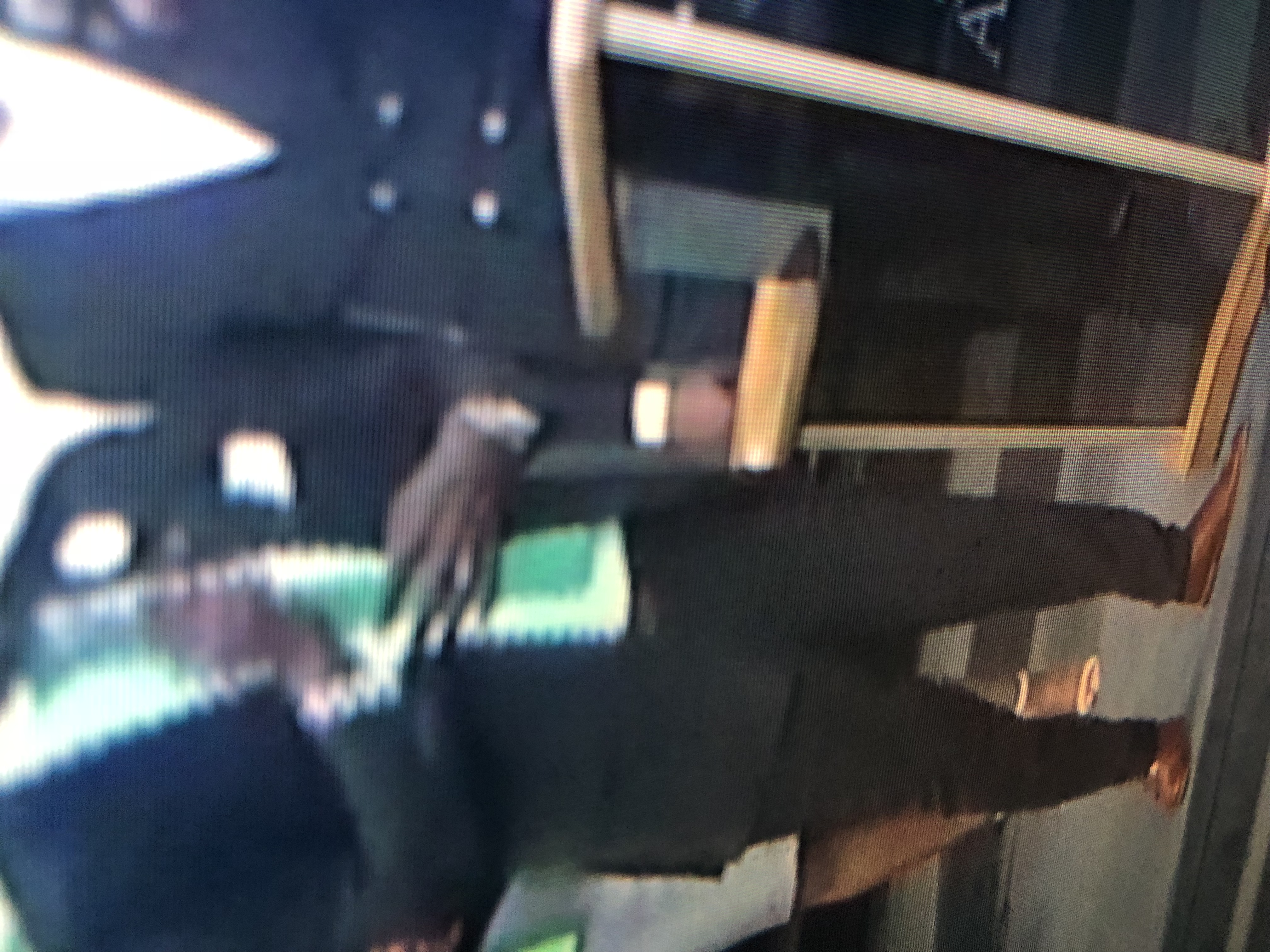

  1. Hello I edit for my local church and there seems to be a weird recording issue which I hope someone can help me figure out. As seen in the picture there seems to be a jittering effect in any movement in recording a moving object. I'm not really as to why this happens but I hope someone could shed some light on this. Thanks in advance.
    PS.The jittering is in the source file aswell before any edits are done.

  3. Below is a scene/trim of a example from the original source included is a picture taken directly on my computer. Hope it helps Image
    [Attachment 44646 - Click to enlarge]

  4. That's interlaced video being resized without consideration of the interlacing. Use an interlace aware resizer or deinterlace before resizing.

  6. The problem is already in the file you uploaded (didn't see the file earlier). You need to go back to the 1080i source. You're editors should recognize the video is interlaced and handle it properly.
