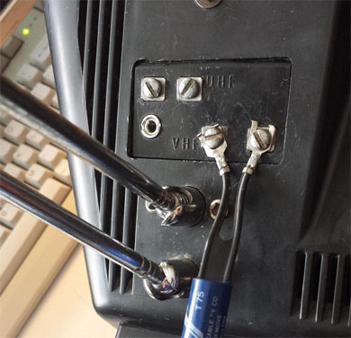

    I guess everything is relative. VGA doesn't make an "old" TV to me. Here is the input connection on an old TV:
    [Attachment 44651 - Click to enlarge]
