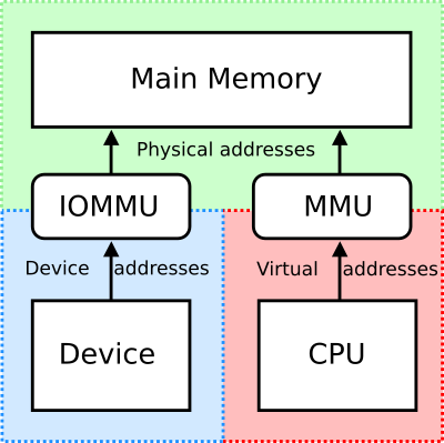

    I had a similar issue with a BlackMagic Intensity Pro, Gigabyte GA-990FXA-UD5 R5 and a AMD FX-8350 CPU, this is my current setup. I was starting to yank my hair off because my capture card didn't work at all on this new setup.
    Don't know if it is your case, go to your UEFI/BIOS setup, in Advanced or Chipset configuration, lookup for a setting named IOMMU, it should be hidden some where. Enable that and boot again, see if your capture card and USB3 devices are up and running.
    If this works for you and are a Linux user, you need to add some boot parameters, otherwise your devices will fail:
    amd_iommu=fullflush iommu=pt
    The first option will clean up the iommu table and the second is a passthru so the kernel can use the board hardware instead of software.

  13. Did you enable IOMMU?

    The USB ports was in my case, you case is different, you have a different board model from another brand. This is a inside information you won't find elsewhere.
    Capture cards are DMA enabled devices, some devices don't need direct access to work and others do, the ones that do need it, they require IOMMU to get there.
    But hey, good luck.

    Thanks for that extra info its much apreciated, because I can aready capture HDV through the Firewire card are you saying that the firewire card may still require enableing IOMMU to capture DV, also I had a brief look in the bios but could not see any settings for this is this setting hidden deep in the bios !
    Crazy as it might sound, yes.
    I've another capture card that has analog input + ISDB tunner, without IOMMU only the ISDB tunner works, the card is detected just fine, the drivers are installed, but still the analog inputs doesn't work at all.

    I've another capture card that has analog input + ISDB tunner, without IOMMU only the ISDB tunner works, the card is detected just fine, the drivers are installed, but still the analog inputs doesn't work at all.[/QUOTE]
    Update regarding enableing IOMMU when I located the setting hidden in the bios it was already set to Auto, but I changed it to enable saved settings in Bios, then tried to capture DV but just the same does not get a signal from camera, so unfortunetly know further forward.
