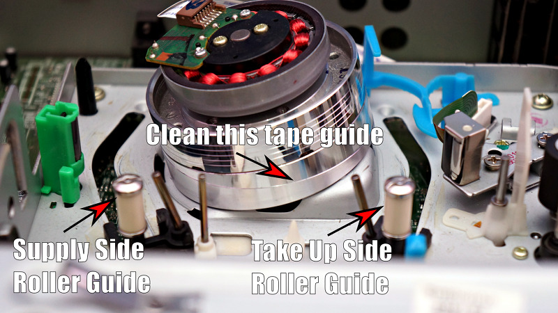

  9. Things you have to know.
    1. You need to clean and grease all the tape mechanism.
    2. Bellow the upper cylinder there is a tape guide that you have to clean up with a tooth pick or another soft but hard material like a bamboo material with a sharp edge like a screwdriver to remove any dirth that can damage the tape, same to all rollers and guides.
    3. Clean the capstan and the pinch roller, the black rubber thing on the right.
    4. Consider a full recap, electrolytic capacitors get dry and old over time, about every 10 years or so. This might cause this no audio or video issues among other things.
    5. This is optional but you have to check this overtime or if the machine has issues tracking the video. You see that S and T guides on the pictures, that is used to do the alignment for the tracking system. To do that you need a tape with SMPTE bars and a oscilloscope, there is a test point on the board that show the direct signal output from the heads, it's a RF signal. Looking at the oscilloscope you must see a retangular bar, if this bar is distorted you have to adjust the S and T guides until you get a perfect retangular shape signal.
    That's it.
    If you don't know how to do it, send it over to a service shop or some one with the proper tools to do it.
