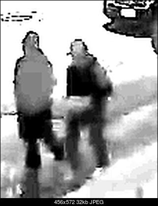

  5. Here's a sample with a big contrast stretch. Other frames look similar. If this had been uncompressed, or much less compressed video, you would have been able to get more real detail.
    Is this the original video? Or has it been reencoded. If the latter, you might be able to get more detail out of the original.

    I do not know if it is the original, but I do not think so since there appears to be a cursor that darts across the field of view at one point.
    I forwarded jagabo's original comments to the person who sent it to me and they said that they were hoping that someone would recognize the clothes and the manner of walk of the persons in the video and perhaps remember seeing them somewhere else where there might be better video or an eyewitness who could make an identification through other means.
    jagabo, the contrast stretched frame is very interesting. Unfortunate that the source is not more usable. Thank you for trying.
