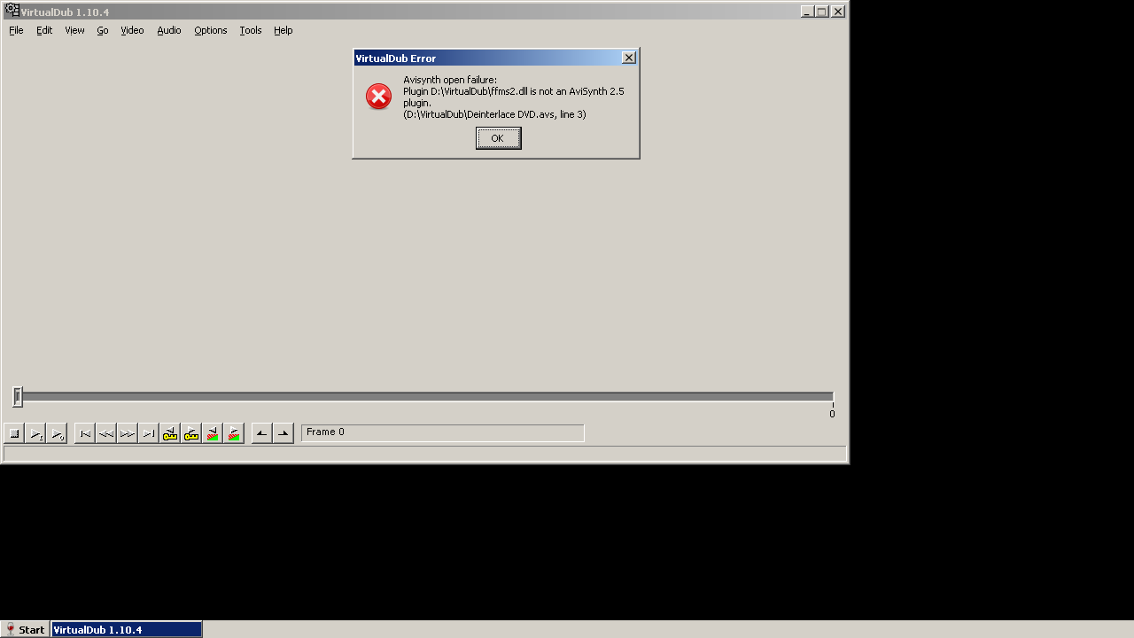

    Why can't load?Image
    [Attachment 44605 - Click to enlarge]
  7. Since it seems you are indeed trying to open a DVD try manono's suggestion instead of ffvideosource().
    What is your OS and AviSynth version?
  8. Originally Posted by sneaker View Post
    Windows 7 32bit
    Avisynth 2.55
  9. 2.55 is wayy (14 years!) outdated. Use AviSynth 2.6.0 or AviSynth+ r2580.
