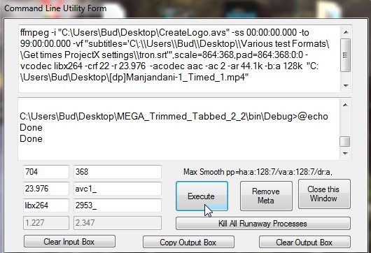

 Code:ffmpeg -i "C:\Users\Bud\Desktop\CreateLogo.avs" -ss 00:00:00.000 -to 99:00:00.000 -vf "subtitles='C\:\\Users\\Bud\\Desktop\\Various test Formats\\Get times ProjectX settings\\tron.srt'",scale=864:368,pad=864:368:0:0 -vcodec libx264 -crf 22 -r 23.976 -acodec aac -ac 2 -ar 44.1k -b:a 128k "C:\Users\Bud\Desktop\[dp]Manjandani-1_Timed_1.mp4"

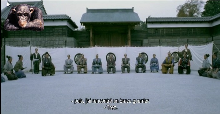

 [Attachment 44580 - Click to enlarge]
 And I encoded successfully:
 [Attachment 44581 - Click to enlarge]

	AFAIK: (Courtesy Elder Geek)
 If you do not set the codec and quality settings for the video codec, ffmpeg will use what it thinks is correct or error out depending on the source. Either way the quality may not be what you want. Since libx264 and aac was used in the original request example, I used the same in my example and showed other possibilities that he might want but do nothing in my example unless it is changed. The format was at least shown though. (-ss 00:00:00.000 -to 99:00:00.000 means entire video, pad=864:368:0:0 means do not pad)I used common H264 codec and its CRF of 22 to output compatible quality and size. The same for the audio although you could use -acodec copy since the audio need not be reencoded.The whole video will get re-encoded if you overlay an image on part of it. One way you could avoid re-encoding the entire thing would be to clip out the portion you wish to overlay and only re-encode that piece (see the -t duration switch and the -ss position switch in the documentation
 The scale and pad settings were because my video was anamorphic (resolution 1.91 but displayed as 2.35).
