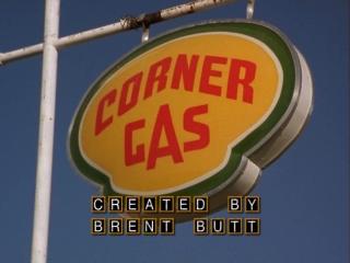

  5. Let's be sure we know what you mean by negative. You mean instead of seeing this:

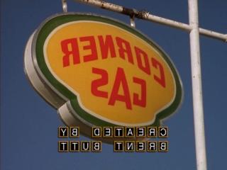

    Not something like this (left/right flip):

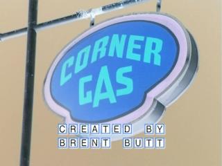

  6. I am see'ing this one. I remember see'ing a license plate and it was legible and not backwards.
    [Attachment 44575 - Click to enlarge]
