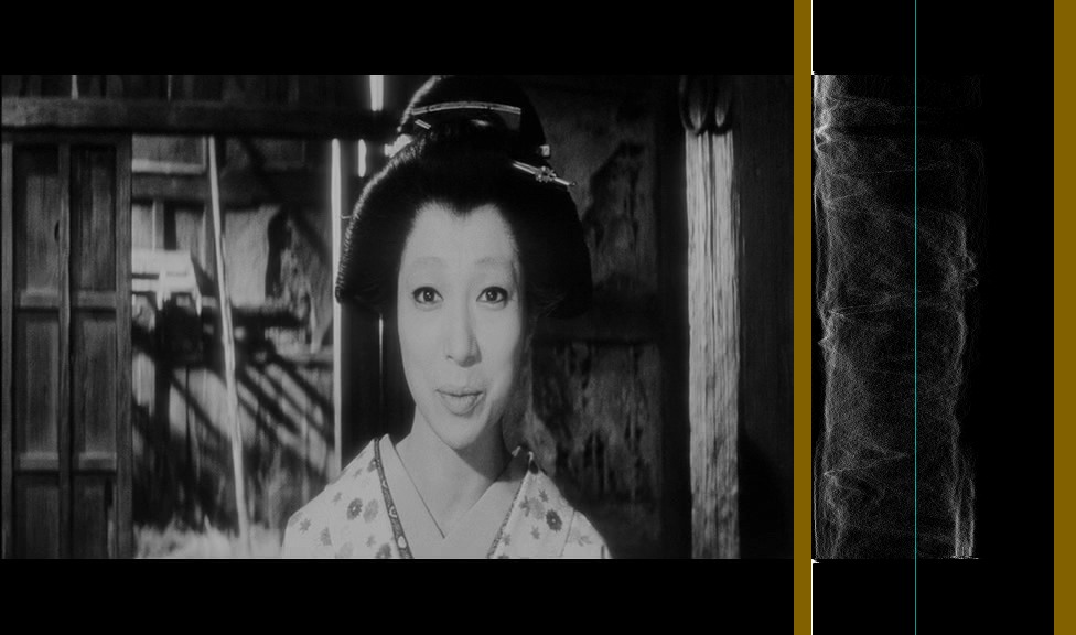

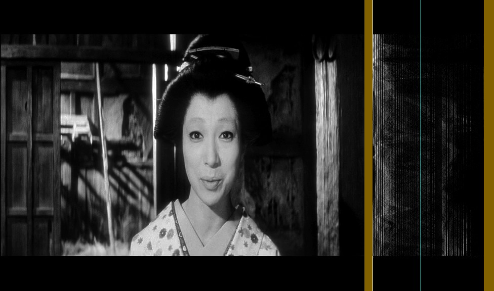

[Attachment 44577 - Click to enlarge]
[Attachment 44578 - Click to enlarge]
Code:ImageSource(...) ConvertToYV24 ## expand range: Levels(0, 1.0, 180, 0, 255) ## lower midrange (inverse gamma) Invert Levels(0, 2.5, 255, 0, 255) Invert ## expand range again Levels(6, 1.0, 200, 0, 255) Histogram return Last
That is going to crush blacks and blow out some of the brighter shots. You need to tone it down a little. I did:
Code:Invert() # negative ColorYUV(gain_y=125, off_y=-101) # contrast stretch to full range Y ColorYUV(gamma_y=30) # gamma adjustment to bring out details in the brights Invert() # back to positive ColorYUV(gamma_y=30) # gamma adjustment to bring out detaiils in the darks ColorYUV(gain_y=-40, off_y=16) # final adjustment back to limited range Y
