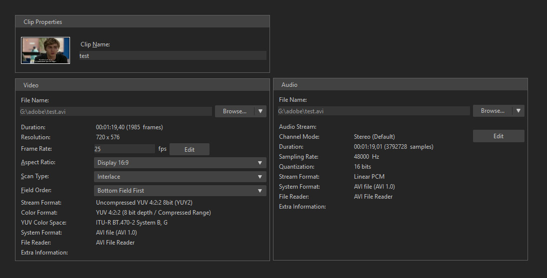

  4. Here are two test captures. One with the Magewell software, one with VirtualDub.
    I converted the 1.6GB uncompressed VirtualDub output to MPEG2, just for upload here.
    The original file's properties can be seen here:
    [Attachment 44570 - Click to enlarge]
