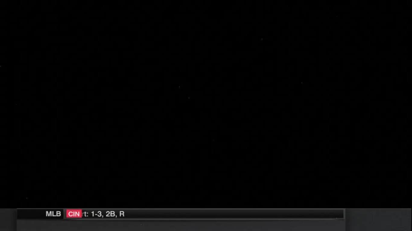

  1. Is it possible to remove white dots from a .ts file? Image
    [Attachment 44567 - Click to enlarge]
  2. It may seem insignificant in the attached pic, but it's much worse in other videos.
  3. There are a few types of filters that can remove that sort of defect. Spacial and temporal noise reducers, dust/dirt removal filters, UnDot filters etc. A video sample would be much more useful. And some context. Is this a video capture? From a digital camcorder? Screen capture? Are they always in the same place? Move around randomly?
  4. Thank you for the response. I've attached a 30 second video sample. This is a Hauppauge PVR video capture to my computer from a Directv Receiver. This specific Directv Receiver produces these white dots that move around randomly, while my other receivers do not do this.
    That's some sort of interference.
    A median filter would also work. You have several filtering options.
    But the ideal thing would be to find the interference, and remove the problem before recording into the video.
  6. Absolutely agree with you about finding the problem. I called Directv earlier today and ordered a replacement receiver. But I have hundreds, if not thousands of sporting events recorded off that specific receiver. So now I must find a way to edit them with something other than VideoRedo. I am currently researching UnDot filters and it seems that AVISYNTH will be necessary to do any such editing.

  9. You mentioned thousands of sports content - If it's sports content, it will be 59.94, but the sample you uploaded is theatrical/film so that's actually 23.976 content in 59.94 (you have 3:2 duplicate pattern) . But I would leave it as 59.94 if it's mainly sports.
    Undot or removegrain(1) is perfect for this, because it's the least damaging and will pickup every dot. removegrain(1) is the same as undot but slightly faster
    Another option is ffmpeg , which has the removegrain filter ported from avisynth. This allows you to batch process very easily, including copying the audio stream into the container of your choice (I would choose mp4 or mkv), and if you have thousands to do, it's just much easier. You basically double click a batch file and it will process all the files in a folder. The output files can take on the same name as the input file and everything is automatic once you set up the batch

  14. The OP mentioned "sporting events" so I would guess he doesn't have much 24 fps film based material. The sample clip (a commercial for a movie) was film with a little 60 fps video in the crawl at the bottom. The spots he's trying to fix change with very video frame.
  15. What you do mean by "sporting events?" 95% of my stuff is sporting events. And all of my stuff is 59.94. I attached a commercial during a sporting event because the dots were most evident.
