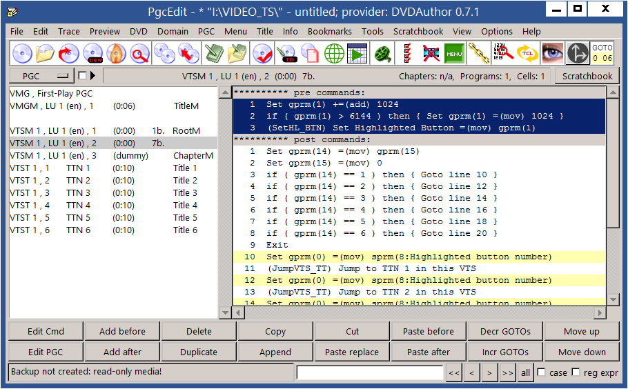

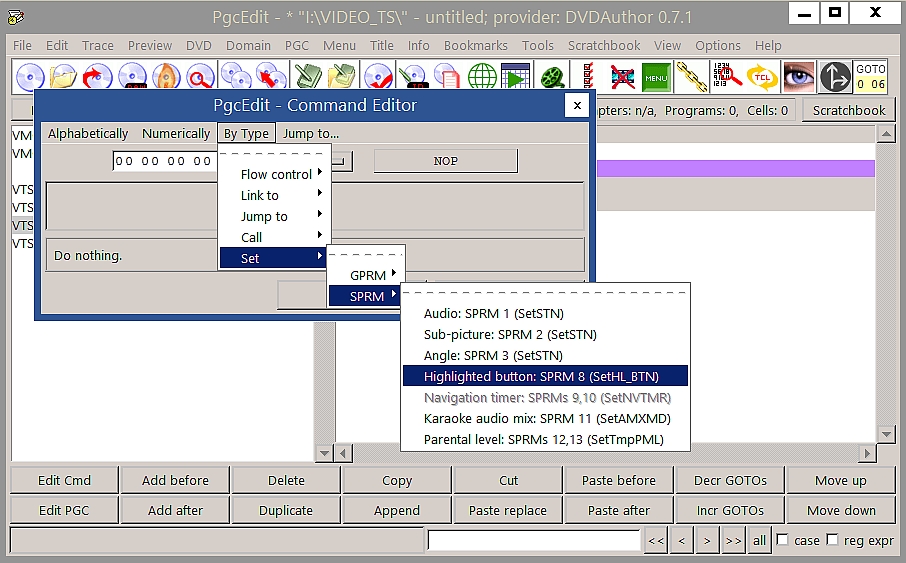

I don't know about step-by-step but say you have VTSM Root menu with a submenu as your "extra" menu . On the submenu are 6 button to select extras and a button to return to the root menu. If you use gprm(1) to hold the value to to be used in SPRM(8) (Highlighted button) then the highlighted pre commands below could be used (Instead of the mentioned modolus operation I use a simple gt 6*1024 (=6144) to highlight button 1 after button 6).
[Attachment 44594 - Click to enlarge]Last edited by videobruger; 4th Feb 2018 at 16:21. Reason: Clarification

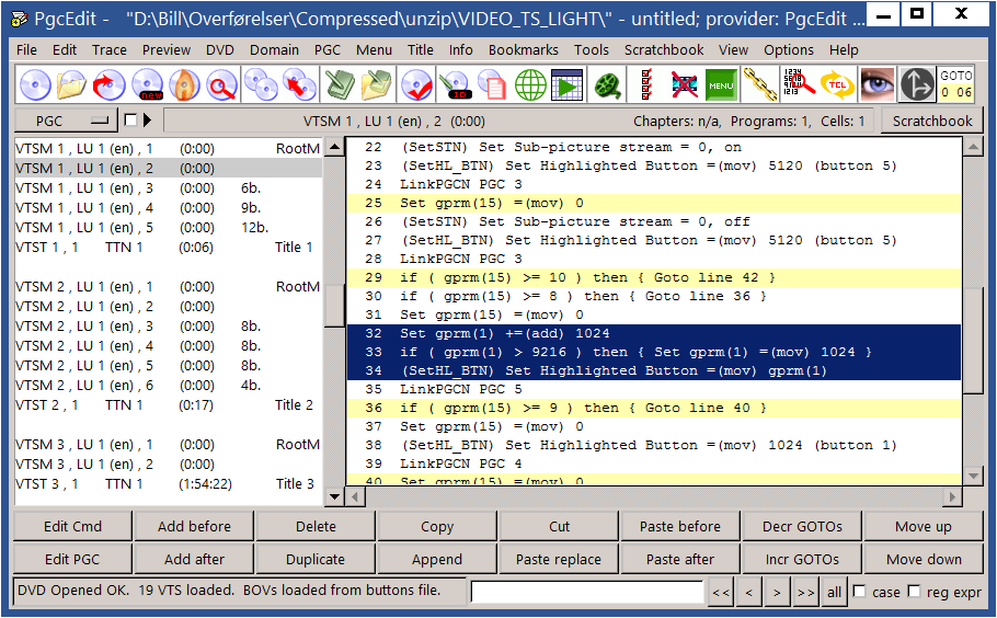

You could try this.

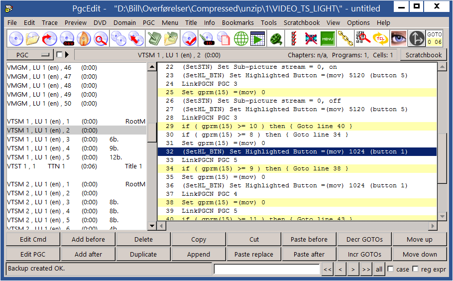

I've changed the highlighted command
[Attachment 44613 - Click to enlarge]
to this
[Attachment 44614 - Click to enlarge]
which I believe does what you want.
A modified VIDEO_TS_LIGHT.zip is attached. -
It almost works.
I had to repeat the selection twice to get the right button in some cases (i.e. after playback of extra #1 I got the button #1 highlighted, I had to playback extra #1 again to get button #2 highlighted. Same with extra #5).
I would like to have the "next extra page" button (button #10) highlighted after the playback of extra #9 (as it is now it returns to button #1). -
Change "9216" to "10240".I would like to have the "next extra page" button (button #10) highlighted after the playback of extra #9 (as it is now it returns to button #1)
[Attachment 44621 - Click to enlarge] -
Maybe I am missing something but it doesn't work.
As I said, sometimes I have to play the same clip twice to get the right button highlighted. More than that, I discovered that if I change the button manually the whole thing becomes unpredictable (I selected button #8 and after the clip playback I got button #5 highlighted instead of #9).
