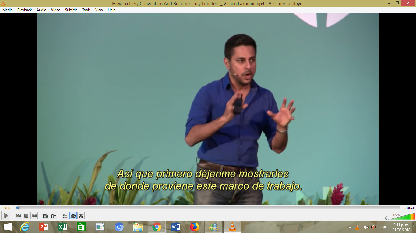

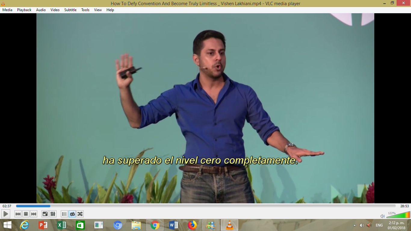

    Hi everyone! I'm pretty new in the subtitling field and I created the srt. files using Subtitle Edit.
    The thing is that when I play or hardcode the subtitles in the video some of them appear in the right place all the way down but some others appear above and it doesn't look good at all. I've tried everything and nothing worked. Here are the print screens as a prove.
    Thank you very much.

  2. Member Bernix's Avatar
    Apr 2016
    Europe
    it seems like empty line, check the lines where it happened if there isn't empty row.
    Edit: in subtitle edit try tools fix common errors. It is first thing there to remove empty lines.
    Bernix

  5. There is a temporal overlap between your subtitles. Ie, a new subtitle starts before the previous one ends. That causes the new subtitle to be drawn above the previous subtitle so both can be seen at the same time (some players may do it differently). Subtitle Workshop can fix that. Tools -> Information and Errors -> Fix All Errors.

  7. Member Ennio's Avatar
    May 2005
    Netherlands
    It can be player associated. In SE --> settings --> General tab, try to set "Min. gap between subtitles in ms" to 50.
    Eventhough if srt end- en starttimings may not overlap, it can be that these timecodes are within the same frame if min. gap is small, and I can imagine a player to react on that as shown.

  10. Member Bernix's Avatar
    Apr 2016
    Europe
    Hi,
    I think, that problem isn't possible in subtitles, but how VLC handles it. Are in Subtitle edit, when have opened video window, subtitles displayed correctly? Try in VLC preference advanced (not simple) settings in subtitles change how they handles it. Or you can try download for example Potplayer and see if they are displayed here correctly.
