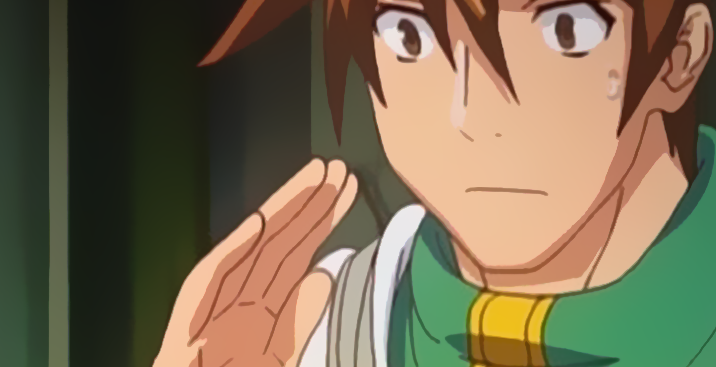

    if i increse the levels (even some times if i dont) it causes the posterization become more visble and it varies in its strength (in different sences)
    i uploaded a smaple for comparison
    1.original
    2.processed with the process i told you and this script

    notice the posterization going crazy aroud his shirt collar
    3.my attempt in fixing the posterization.

    also added 2 other samples- 1.with the first script 2.second with an attempt to fix it(didnt add the original)

    [Attachment 44562 - Click to enlarge]

    i didnt understand your quastion and what you ment by posting part of the pic. what i generally try to get is more "clean" animation.
    by eliminating noise and artifact and making the lines more firm and distinct.
    the problem is that the process i do some times either causes or stresses out already present posterization (because of levels() increse)
    and i am trying to figure out how to get rid of it.
    you can download the samples and see
    video - 1 its the original
    video - 2 you can see posterization around the shirt collar
    video - 3 i tried fixing it with the last script
    and i want to hear out more about this thing, how to avoid it or to take care of it
    edit:also you cant notice the posterization in the pics only in the video samples
  4. TTempSmooth() can lock the pixels down but may create smearing artifacts in panning shots if you set it too high and there will still be posterization. So follow it with GradFun3().
