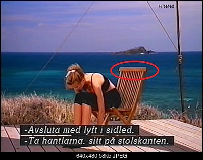

    Im just at the start of a process of capturing some old home videos. Im trying to find a good procedure.
    My budget is low, Im caturing from a LG combined DVD/VHS, but Im using the composite out and capturing that with a König USB device. No TBC.
    The result is quite good. And the aim is to have the videos on my NAS to stream to my popcorn hour mediaplayer.
    Im capturing in Virtualdub with Lagarith YUY2 compression.
    And Im post-processing in Virtualdub with the following filters:
    1. Yadif double framerate deinterlacer
    2. VHS Flaxen - just the chroma shift part
    3. Neat video to reduce noice
    4. crop and resize
    5. Levels
    I then compress with Handbrake to h.264 in an mkv
    The result look quite good on my 50inch TV

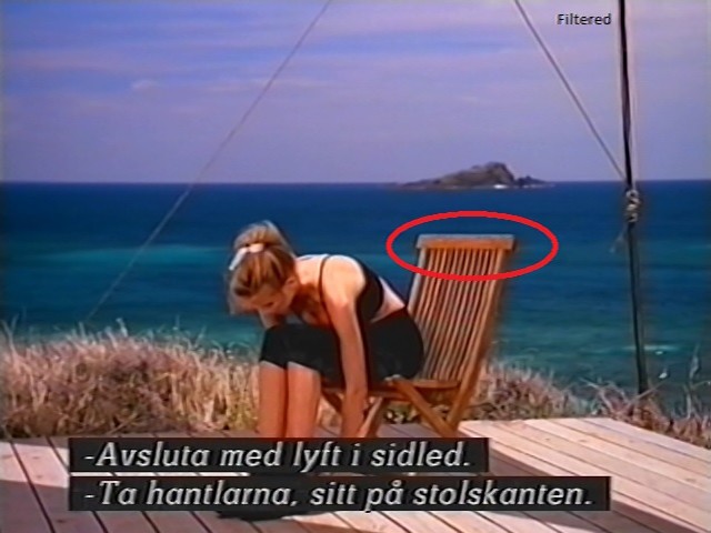

    But I have some noice that I need to filter really hard in Neat video to get rid of.
    And I was wondering if anyonehere could give I clue to what it is and if it is possible to get rid of?
  2. Dot crawl artifacts: https://en.wikipedia.org/wiki/Dot_crawl
    Yes, you can reduce them. A downscale to ~half width, horizontal sharpen, and upscale back to full width will work if the video isn't too sharp to begin with:
    I did that in AviSynth with:
    Spline36Resize(width/2, height)
    Sharpen(0.2, 0.0)
    TurnLeft().nnedi3(dh=true).TurnRight()
    You can combine something like that with an edge detection filter to overlay the blurred image only where there are colorful edges.
    By the way, if you search through these forums you'll find lots of posts about "dot crawl" and ways of removing it. If you want your particular video addressed more specifically you should upload a sample (of the original video, not a reencoded clip).

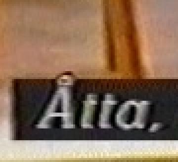

  17. Ah, thanx. Those are very clear examples. And I agree that it is very visable in the yellow video. Nevertheless, beeing in Europe, a EH deck would be what I should be looking for. And so far I havent seen any. But Ill keep looking. And I understand that post-filtering will nor sort this out.
    What about blurriness of e.g the left vertical subtitle edge? What could be the cause? It is frame fixed, so it shoulnt be caused by deinterlacing I guess? Possible to sort in post-filtering?
  18. Originally Posted by sventamyra View Post
    VHS is an inherently low resolution format. It only has the equivalent of about 320 pixels of resolution across the width of the screen. So you will never get nice sharp vertical edges/lines. To improve the picture a little, many VHS decks include crude sharpening filters. This works when viewing a small CRT from far away, but when watching on modern, large, high resolution devices it's obvious the picture is over-sharpened. There are bright/dark halos on all high contrast vertical lines and edges:
    That's a 4x point resize enlargement of a portion of one of your images. Notice how each white letter has an extra dark halo to the right and left. And the dark chair leg has bright halos to the left and right.
    Advanced oftware sharpeners can to better (but still not work miracles) if you start with a capture that doesn't have those halos. If your VHS deck has a sharpness control turn it down. If your capture device has a sharpness control turn it down too. It's possible to reduce the halos post-capture but a lot of detail will be lost along with the halos. If you attempt sharpen without reducing the halos you'll accentuate them.
