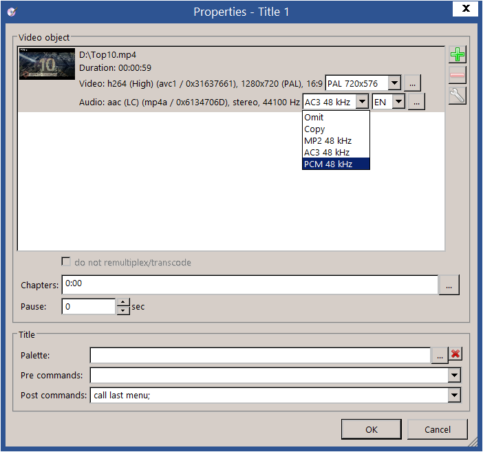

  4. Originally Posted by videobruger View Post
    Just to mention: DVDStyler also offers PCM.
    [Attachment 44537 - Click to enlarge]
    Sorry, I haven't reached to THAT menu so far... I just got stuck with the initial choice between MP2 and AC3.
    I don't mind about adding more audio tracks (only one, music) nor file size (each programme is short, much shorter than a movie, so plenty of available space on a 4.7 GB DVD). I just want to avoid altering/tampering with the original audio as much as possible...
