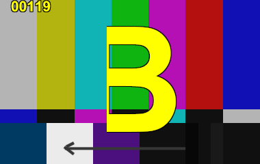

  4. Use my script with "right" changed to "left."
    As I explain in the script, you need two copies of the clip - one without the overlay, one with the overlay.
    You wipe from one to the other.
    [Attachment 44528 - Click to enlarge]

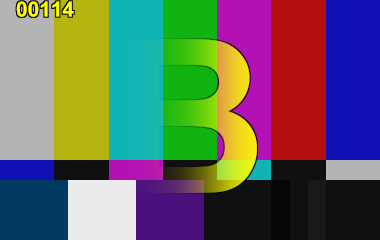

  7. Very well sir You force me to post my own script, which features an adjustable soft edge.
    [Attachment 44536 - Click to enlarge]
