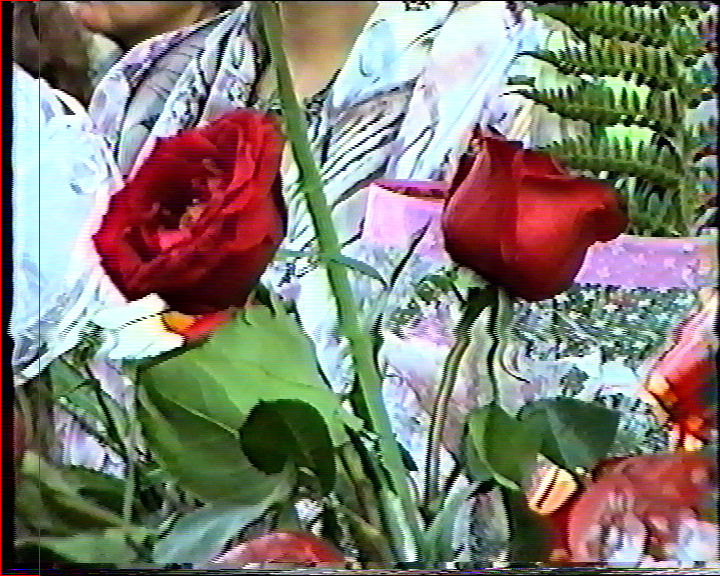

  22. One curious thing that I have noticed is that this kind of "bleeding" artifact only occurs when I connect the VCR to the computer through the stick. When it's connected to the Sony Bravia TV then the image is good and no "bleeding" occurs.
    It just happens on a couple of tapes from the ~30 collection though. One of them is "bleeding" so hard that it's impossible (more like, doesn't make sense) to capture.
  23. Bleeding? You mean the way the top of the picture leans to the right? That's called flagging. The line TBC should take care of that.
  24. Originally Posted by jagabo View Post
    Thanks for correcting. Apparently the TV has got this function.
  25. TVs are much better than capture devices at handling sync irregularities.
