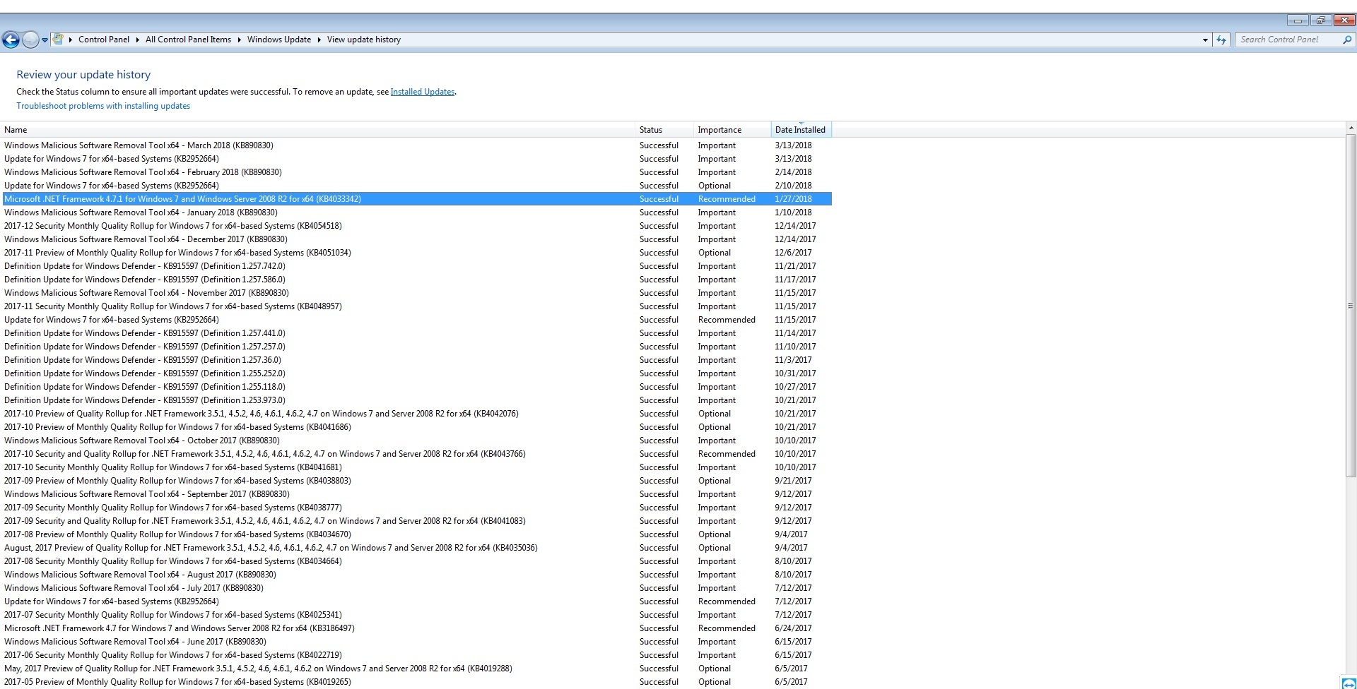

  26. Member
    Mar 2018
    Romania
    Looks like the updates went through for the laptop with AMD GPU.
    There is no hidden update.
    There are no other updates just optional updates (language packs).
    Also there are updates that went through after January, in Feb and in March.
    Please see the picture.Image
    [Attachment 44954 - Click to enlarge]
  27. Senior Member c627627's Avatar
    Kansas
    Thanks for posting that.
    The Security Monthly Quality Rollup with any date from 2018 is the Arcsoft killer.
    I am concerned that your screen shot shows the last Security Monthly Quality Rollup being from 2017-12.
    It may be that TMT3 is not affected but we are in March 2018 so it may be that any Security Monthly Quality Rollup of the three: 2018-01 or 2018-02 or 2018-03 would end up killing Arcosft on your AMD system if applied?
    Your nVidia Laptops, do they show Security Monthly Quality Rollups from 2018? If yes, then sadly maybe that's why they don't have working Arcsoft programs.
  28. Member
    Mar 2018
    Romania
    I checked and each of Nvidia laptops have all 3 Security Monthly Quality Rollups from 2018, Jan, Feb and March.
    Maybe AMD laptop has a problem that prevents to get these SMQR?
    But is is very strange that the laptop still receives updates but not the SMQRs.
    I found this possible explanation here for January SMQR: https://support.microsoft.com/en-us/help/4056894/windows-7-update-kb4056894
    "Microsoft has reports of some customers on a small subset of older AMD processors getting into an unbootable state after installing this KB.

    You can uninstall Windows updates from Windows Update\View update history
    or maybe from
    Control Panel\All Control Panel Items\Programs and Features then View Installed Updates
