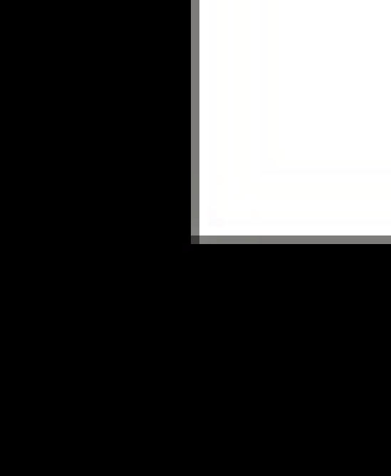

    Sorry,
    just one example of Waifu2x on straight lines. Original was just Black and white color. No more.
    [Attachment 44485 - Click to enlarge]
    And just multiplied by 2
    [Attachment 44486 - Click to enlarge]
    Of course it is zoomed, but is it easiest task for scaling.
  6. Originally Posted by Bernix View Post
    Sorry,

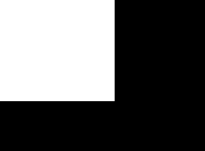

  7. Member Bernix's Avatar
    Apr 2016
    Europe
    I was talking about the original image hasn't that grey in between black and white. Nor the grey in the corner. And resize square, not rotated any angle should be easiest think on the earth. I believe all usual resize algorithm can do this without those grey colors.
    Here is original image before waifu2x resize
    [Attachment 44488 - Click to enlarge]

  8. Member Bernix's Avatar
    Apr 2016
    Europe
    O.K. it isn't simple task then, only for nearest neighbor then. Apologize.

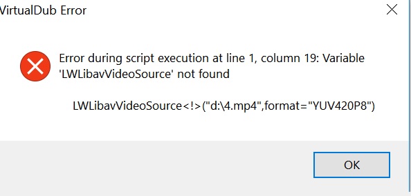

    ok everything looks to work fine , the only thing is i still cant get virtualdub to run with avisyth.
    i extract the VD files into some folder. run it (32 bit or 64 tried both) and it can only play avi files.
    is there a specific way i need to set it up?
  12. Originally Posted by zanzar View Post
    Post your AviSynth script and the error message you get.
  13. Image
    [Attachment 44489 - Click to enlarge]

  14. Use File -> Open Video File to open AviSynth scripts. Not File -> Run Script (that's for VirtualDub's own scripting language).
  15. Originally Posted by jagabo View Post
    thanks ! everything works great , now last thing.

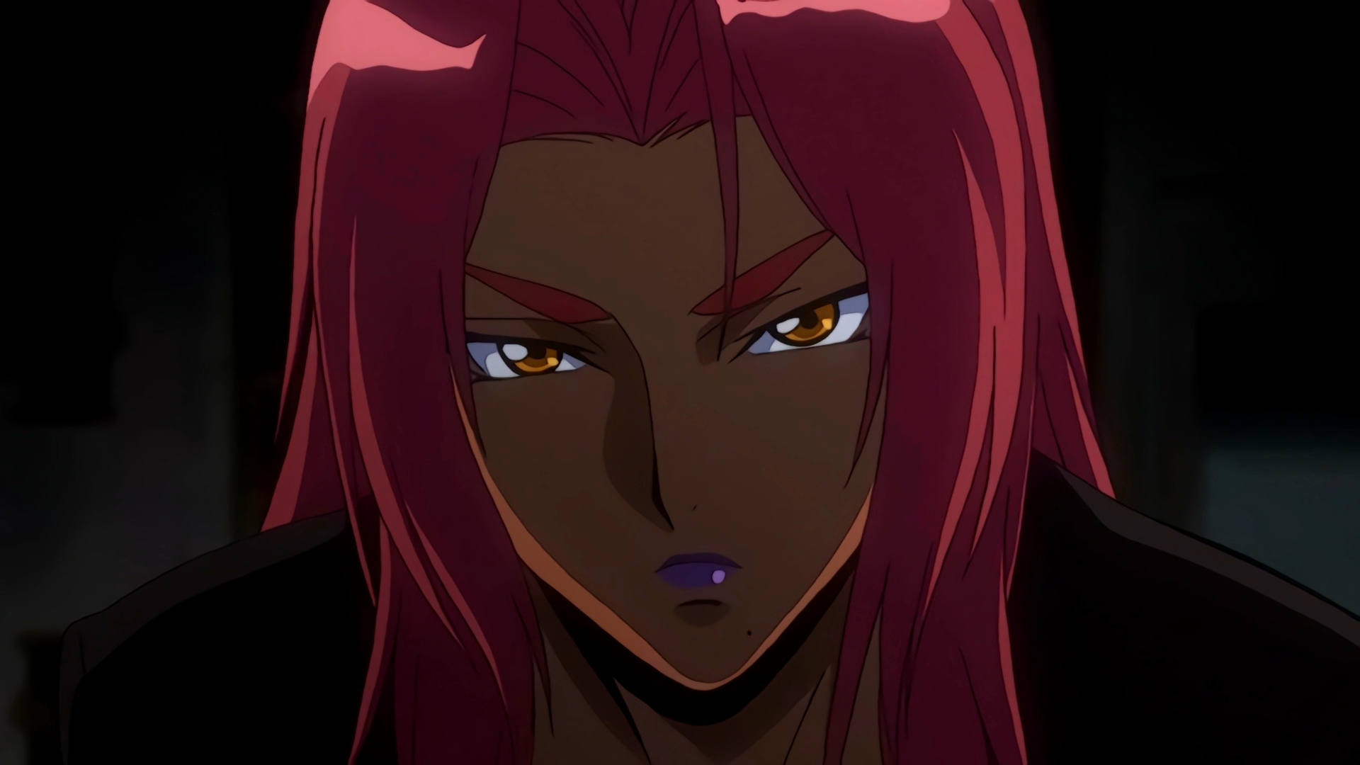

    jagabo any idea what is this artiffacts coused by increasing the levels?
    levels(19, 0.85, 246, 5, 255, coring=false)
    i think its present even without the levels , just much less visable.
    any idea how to get rid of it ? its mostly present on draker colored frames and not on multicolored ones.

  18. Originally Posted by zanzar View Post
    You think ?? Did you look at the original ?
    If it's there - you should clean it up before everything else, before upscaling, otherwise you just upscale artifacts
    jpg doesn't help either (lossy even at highest quality) , it was mentioned above you should use png
    You might have to apply dithering at the end to cover up problems
    its there in the original. its just that levels makes it worse. also it has nothing to do with the jpg.
    it is only noticable at this scene
    how do i clean it?
  24. It's posterization. In 8 bit rec.601 or rec.709 YUV video there are only about 1/6 as many unique YUV values are there are in 8 bit RGB, even though they both cover the same range of colors. That means there is a bigger "distance" between adjacent YUV values. When you use levels to increase the contrast the distances become even bigger. Try using SmoothLevels() instead of Levels(). That will add some noise and make it less visible. Or maybe use GradFun3 before or after the levels adjustment.
