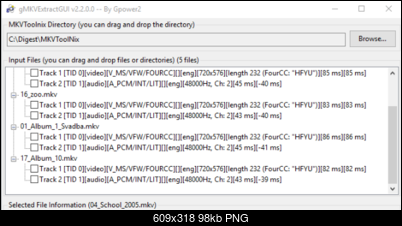

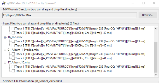

    After checking file in gMKVExtractGUI
    I noticed that input audio has a delay in 40 ms. Other in 39 ms.
    Now I don't know how to correct it in settings on MKVmerge
    I tried using option -y 2:40
    full code
    -o "%(outputname)" -y 2:40 --default-duration 0:%(fpsnum)/%(fpsden)fps "%(tempvideofile)" "%(tempaudiofile)"
    Please let me know how to set delay correctly?

  5. In mkvmerge the TrackIDs for input files restart for every input file. Mkvmerge knows which input file they belong to because of the order:
    -o "%(outputname)" --default-duration 0:%(fpsnum)/%(fpsden)fps "%(tempvideofile)" -y 0:40 "%(tempaudiofile)"
    https://mkvtoolnix.download/doc/mkvmerge.html#mkvmerge.track_ids

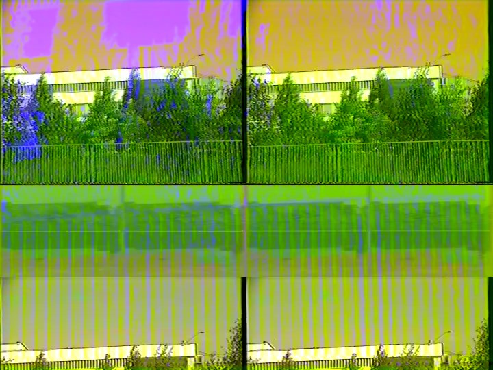

  28. Hey guys!
    I used 16 bit hopefully I will get video with redudant possibilities for editing. But what I got:
    [Attachment 44479 - Click to enlarge]
    with next code
    --crf 19 --preset medium --input-res %(width)x%(height) --input-depth 16 --input-csp i420 --fps %(fps) - -o "%(tempvideofile)"
    What is my mistake?
  29. --input-depth 16 only tells x264 that the input is 16 bit. If the input isn't actually 16 bit you will only produce garbage.
    How does the picture look in the VirtualDub preview? Are you using AviSynth? Show "File"->"File Information" and MediaInfo ("View"->"Text").
