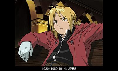

  1. This does not look like a simple shift them over a tad with chroma shifting. They seem out of place almost as if the Blu-Ray was scaled badly or something. Its very easy to notice especially near black lines.
    (Image Removed)
    I tried chroma sharpening with mergechroma(awarpsharp2(depth=10)). It seems to help some but it does not exactly fix the issue.
    Does anyone whats up with this or how to adjust it better than just chroma sharpening it?

  2. That HD video looks liek it was upscaled from an analog SD source with low horizontal chroma resolution. You need to sharpen and shift the chroma horizontally. Something along the lines of:
    ImageSource("28My6hp.png", start=0, end=23, fps=23.976)
    ConvertToYV12()
    U = UtoY()
    U = U.BilinearResize(U.width/2, U.height).aWarpSharp(depth=10).nnedi3_rpow2(4, cshift="Spline36Resize", fwidth=U.width, fheight=U.height)
    V = VtoY()
    V = V.BilinearResize(V.width/2, V.height).aWarpSharp(depth=10).nnedi3_rpow2(4, cshift="Spline36Resize", fwidth=V.width, fheight=V.height)
    YtoUV(U, V, last)
    ChromaShift(c=-2)
    Or, if you know that U and V need the same treatment:
    ConvertToYV12()
    MergeChroma(last, BilinearResize(width/2, height).aWarpSharp(depth=10).nnedi3_rpow2(2, cshift="Spline36Resize", fwidth=width, fheight=height))
    ChromaShift(c=-2)

    Of course, you might want to sharpen the luma too.

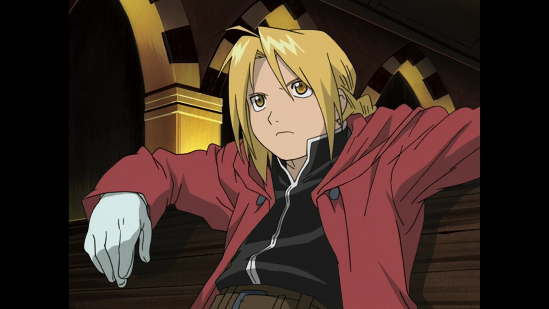

  3. Is this good enough for this in your opinion?
  4. It's up to you.
