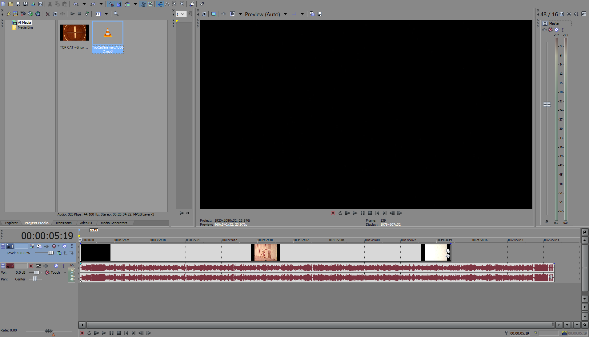

    Hey JV.. wow.. thats quite a bit more work than what I thought I would have syncing audio.
    This is all super confusing for a noob like myself. Ive attached an image to try and understand a bit more. Ive set the frame rate to 23.976fps. The raw audio from the projector is longer by about 6 minutes or so. Usually what I try to do and sync it is, stretching the video speed to the end of the track to start with. Then Ill zoom in and find a sync point.. and pull the video to match the audio.. then it rolls at out of sync after about 2 or 3 minutes. Some of it could be due to a missing frame or a splice I suppose.. but I'm sure its more than that.
    If I adjust the sound speed and try and trim it back to the length of the video.. well.. its obviously too fast.
    Shouldn't adjusting the frame rate adjust the time of the video? It does for me in VirtualDub, but not Vegas?
    I'm trying to understand guys..I swear.

  10. The video is shorter 20 percent shorter than the audio because 24 fps film was captured frame-for-frame but marked as 29.97 fps. Converting it to 23.976 fps in Vegas doesn't fix the running time, it discards 20 percent of the frames. You need to convince Vegas your video is really 24 fps. I believe you can do that by right clicking on the video in the timeline (or media assets section) and selecting Properties -- or something like that (I don't use Vegas).
    For your samples, don't render in Vegas. Use a simple cut editor to extract a short section without any other changes. If your video is AVI you can use VirtualDub to do that. Just set Video -> Direct Stream Copy before marking and saving the clip. And if your video is AVI you can use AviFRate to change the frame rate of the video without otherwise touching it.
