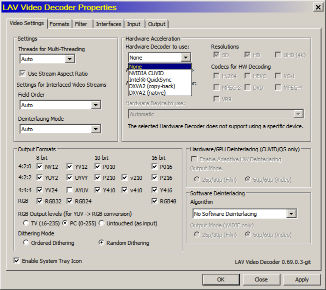

  15. Marsia Mariner
    Guest
    @KarMa:
    just make sure LAV Video is configured to use hardware-decoding while Avisynth uses the .GRF file.
    Assuming there exists an HEVC decoder in the GPU, of course.
