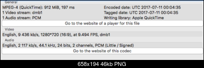

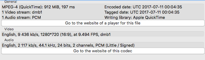

  6. Click image for larger version
Name:	Screen Shot 2018-01-20 at 4.54.31 PM.png
    I'm attaching a screenshot of the MediaInfo analysis. Hopefully you can see this as the site won't let me put it into this post.

  8. Originally Posted by Bandwidth View Post
    [Attachment 44450 - Click to enlarge]
    video stream: dmb1
    https://www.fourcc.org/dmb1/
    "Hardware codec used by Matrox Rainbow Runner video capture product. Apparently a form of Motion JPEG."
    https://www.google.com/search?q=decode+dmb1+video
    VLC and mplayer -- and some others -- say they can decode this. Give those two a try. (AFAICT, ffmpeg does not decode it.)
    Don't install any codecs or software other than the ones I just mentioned without first asking the experts here!

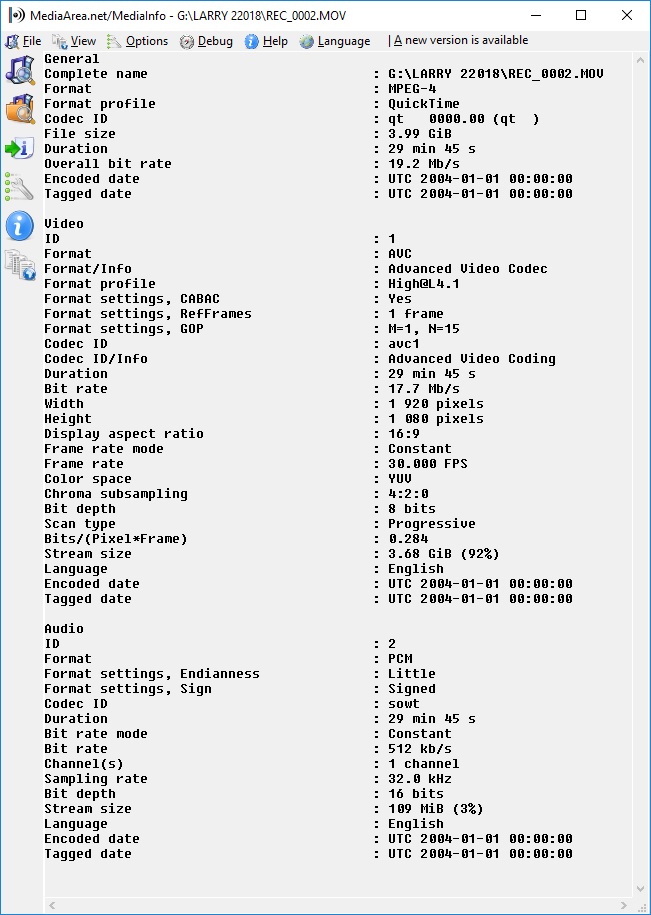

  10. Mod Neophyte redwudz's Avatar
    USA
    MediaInfo seems to think the file is 197ms long. Which is unlikely. I use the 'Text' output in MediaInfo.
    What I've done with problematic .MOV files is try to open them in VirtualDub FilterMod
    in it's HEX editor. (Under 'Tools'). If you see a lot of zeros, probably no video there.
    Typical MediaInfo file of a .MOV from my camera:
  11. Member Cornucopia's Avatar
    Good catch. 912 x 8 / 0.197 = 37Gbps! Something's up. Also 9.4fps?
    Corrupted, most likely.
