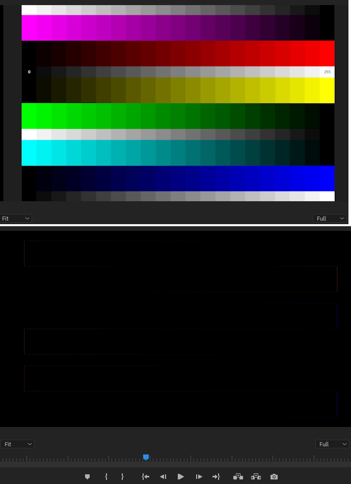

    In PP I see the same colors, but there is an outline at the bright colored edges in layer difference mode. Does it look like RGB <=> YUV loss?
    [Attachment 44438 - Click to enlarge]
    voukoder has NVENc implementation planned on the timeline - that would be direct encoding from PP and faster because it can pull YUV frames directly, no afs or avisynth overhead.
    It is very interesting. Does anybody know how it works?
    Could be, but you have it set to "fit" which might resize some artifacts
    Artifacts on vertical bars suggests chroma resizing , but you'd expect that on other bars as well, not just on the outside edge

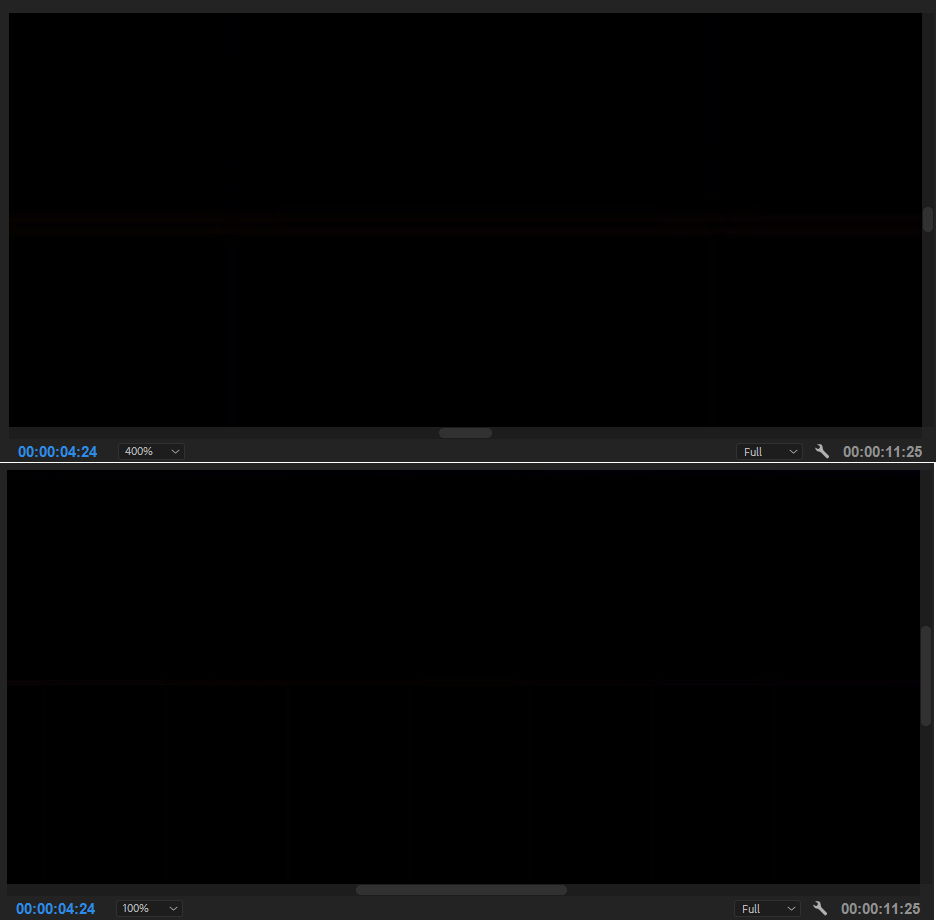

    100% and 400% does not change anything.
    [Attachment 44441 - Click to enlarge]
    I saw the same outlines with voukoder lossless hevc. And I have no idea why it happens. But voukoder works faster and better than afs. And even better than nvenc plugin 1.12.

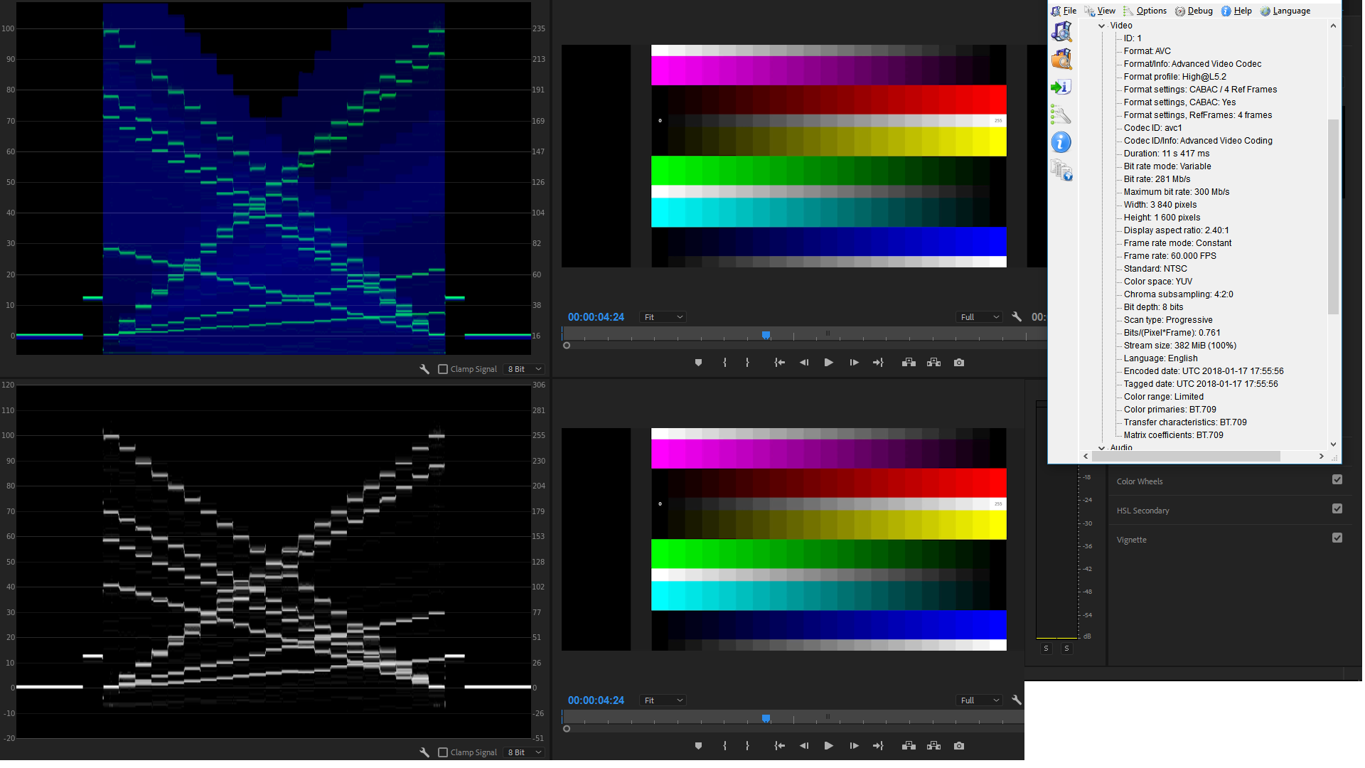

    In PP the waveform will show <0 or >100 IRE if you have full range YUV values and you set the waveform not to clip . Those values are "recoverable" with YUV filters. They are known as "superbrights" and "superdarks"
    It might be PP decoding issue. It had problems decoding hevc lossless profile, but AVC lossless was fixed a while back
    Waveform shows full range in RGB (recovered) and 16-235 YUV, mediainfo - limited. AE shows the same artifacts in difference mode.
    [Attachment 44445 - Click to enlarge]
    I don't think that it is PP issue:
    [Parsed_ssim_0 @ 0000022df4dfef00] SSIM Y:0.999932 (41.651371) U:0.999964 (44.418718) V:0.999966 (44.746317) All:0.999943 (42.426614)

    RGB is always 0-255. You have no Y values above 100 or below 0 (ie your test doesn't show full range values) . Mediainfo only reads the header , it doesn't scan the file so it does not indicate any useful information (you can have full range values with a tagged limited range "label" , or limited range values only with a tagged full range "label")
    It's definitely a premiere decoding bug. It doesn't support lossless hevc profile decoding. HEVC using libx265 is lossless in other programs/decoders , even when exporting from PP. There might be other problems with NVEnc HEVC , I don't have a pascal card to test
    But AVC (libx264) lossless decoding is fixed in the last few PP versions . You can use NVEnc lossless AVC (not sure if it's available in the vouk plugin)

  18. Originally Posted by qo4on View Post
    If so, why AE shows the same? I tried to compare original file with png picture which was created from encoded file. It showed the same artifacts. Why ssim and psnr shows lossy?
    [Parsed_psnr_1 @ 0000022df8625a80] PSNR y:54.334727 u:69.354318 v:68.732008 average:56.022632 min:27.665726 max:inf
    Because it's an Adobe issue. Adobe makes AE too...
    It took them a few years to fix the AVC lossless issue. I don't expect a quick fix HEVC lossless decoding...
    SSIM and PSNR are lossless when I use libx265 export from Adobe. Confirmed with multiple tests. It's a decoding issue with Adobe. Make sure your frames are aligned (that plugin has issues with short tests and timecodes). It's also possible that NVEnc or that specific implementation has problems , but software HEVC bitstream is the "gold standard" to test against. If that has problems, then everything else will have problems. That' s how you know it's a decoding issue. It was the same thing with AVC lossless a few years ago
    (You take a known AVC input stream, encode it with HEVC externally , test it externally. If it's proven to be lossless, you import all streams into PP or AE or anything Adobe and it will show "non lossless", but lossless in everything else. The 2nd test is exporting that AVC input with libx265 lossless, and testing that externally. That too is lossless . So the AVC decoding pathway works . It's the HEVC decoding pathway that has problems)
  19. AE was a different company before. It has absolutely another engine. SSIM and PSNR are lossless with libx265, and not lossless with nvenc hevc. I checked this without Adobe programs. My frames are aligned for sure. I think it is nvenc hevc issue.
    We can close this branch as AFS and avisynth is no longer needed. Voukoder is very good! I will post short source and nvenc hevc encoded example in another branch of this forum which I have created for that.
