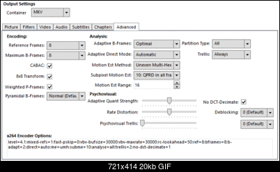

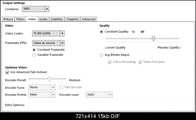

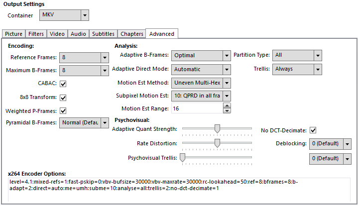

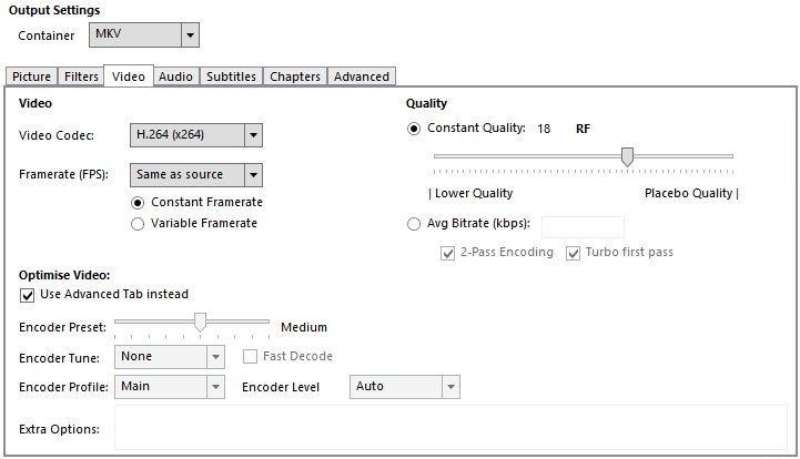

  1. I've spent a good amount of time trying to figure out the best settings for encoding my video collection. I mostly have movies, TV shows and animations. I want the results to look the same as the source without any noticeable difference in quality while still reducing size as much as possible. Encoding speed is not important to me, but would like it to be reasonable. I use Android based TV boxes to play back content and backward compatibility with older or low spec devices is not important. My settings are already very aggressive and I'm looking for some advice on whether I went too far in some cases or perhaps not far enough.
    Originally I was going to go with a Constant Quality Rate Factor of 16, but after doing some tests I decided to settle on 18 because I couldn't see a difference in quality. Any reason I should be going back to 16? Any settings I could change to further increase quality or reduce file size without encoding time getting really out of hand?
    My biggest concern is some of the settings that were added manually such as mixed-refs, vbv-bufsize, vbv-maxrate, and rc-lookahead. Are they too aggressive or would they even have a noticeable impact on the final quality or file size? Should I use separate settings for film and animation or would these work equally well for both?
    Due to these settings the encoding speed is fairly slow, but I suppose that's the price for quality. Any advice on how to increase encoding speed without any impact to quality or increase quality further while keeping or reducing file size would be greatly appreciated.

    Just use the x264 presets, using the slowest setting you can stand the better. CRF 18 is generally considered transparent for HD, with SD requiring a slight lower CRF than HD for similar quality.

  4. Your settings are almost identical to preset veryslow. Actually, preset veryslow uses higher rc-lookahead and merange. no-dct-decimate is part of tune grain. Hard to tell from your screenshots but you may also be missing out on high profile and "overshooting" level ref limit.
    Don't shit on the presets if you don't understand them. There's a reason we recommend using presets + tunings.

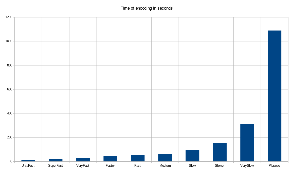

    Best quality for H264 is somewhere around CRF 12, if you want lossless, you can achieve minimal difference at cost of very much big file. Even 12 seems to me be too low, CRF 14-16 should be good enough, especially using placebo, which is nonsense, slow should be enough.
    HERE is time encoding example by presets. Video has 180 sec. On average computer, don't remember if H264 or H265, but relative times should be in same or in worst case similar ratio.
    [Attachment 44437 - Click to enlarge]
    Edit And compare statics images from video, with minimal difference is also IMHO nonsense.
