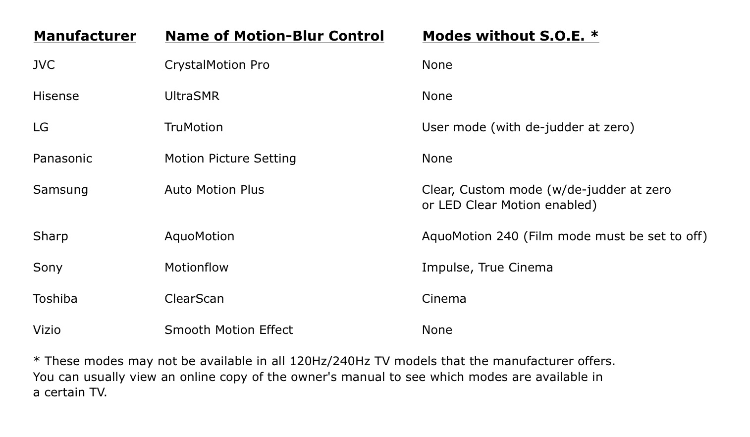

  7. The Home Theater Review site has an article on the 'soap opera effect' and how to get rid of it for various brands of televisions. For LG it's called TruMotion:
    https://hometheaterreview.com/what-is-soap-opera-effect-and-how-to-make-it-go-away/
Name:	SOE chart.jpg
