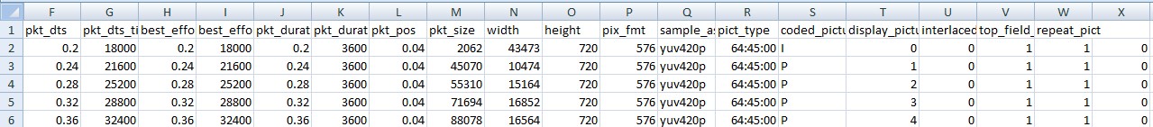

  7. ffmpeg's ffprobe.exe can write a .CSV file (easily opened in any spreadsheet program) with a record of presentation timestamps (the time a frame is displayed) along with packet positions (the position of a frame in the video stream - I think). I made a batch file and wrote it up here, but the heart of it is very simple:
    @echo entry,media_type,key_frame,pkt_pts,pkt_pts_time,pkt_dts,pkt_dts_time,best_effort_timestamp,^
    best_effort_timestamp_time,pkt_duration,pkt_duration_time,pkt_pos,pkt_size,^
    width,height,pix_fmt,sample_aspect_ratio,pict_type,coded_picture_number,^
    display_picture_number,interlaced_frame,top_field_first,repeat_pict > "ffprobe.csv"
    ver > nul
    ffprobe.exe -select_streams v -print_format csv -show_entries frame "my_file.xyz" >> "ffprobe.csv"
    Opened in a spreadsheet, you see:
    (beware, the columns ffprobe puts out may have changed since 2014 when I last used it)
    (EDIT you need to understand Scott's post #4 to even begin to understand this data)

    Great stuff Raffriff42!! The output might have changed a little (ffprobe 2015) but its all there if, as you and Scott mentioned, you understand the data.
    [Attachment 44467 - Click to enlarge]

    @RaffRiff42... In thread number 7, I noticed the 'display_picture_numbers' are not in sequence although the times are increasing at a regular rate. Any Ideaswhy they are shown this way?
  19. That's because a long-GOP codec writes the frames out of order - I'm not really up on the details.
  20. Member Budman1's Avatar
    Jul 2012
    NORTHWEST ILLINOIS, USA
    @raffriff42 ... Thanks. With that I was able to find the following which explains the order. Unfortunately, when you seek to a particular frame, it is (I believe...) the display sequence. The CSV output shown earlier makes this hard to parse with the correct display timing. At least its understandable now. Thanks for the valuable info.
    Display order: I(1) B(2) B(3) P(4) B(5) B(6) P(7)
    Transmit order: I(1) P(4) B(2) B(3) P(7) B(5) B(6)
    The short answer for why this is so: Due to the bidirectional nature of B frame prediction the decoder must first process the previous and next reference frames. For example, to decode B(2) the decoder must first have I(1) and P(4).
    The easy way (for most sequences) to reorder frames from transmission to display is to look at the temporal_reference in the picture header which gives you the location of the frame in display order.
