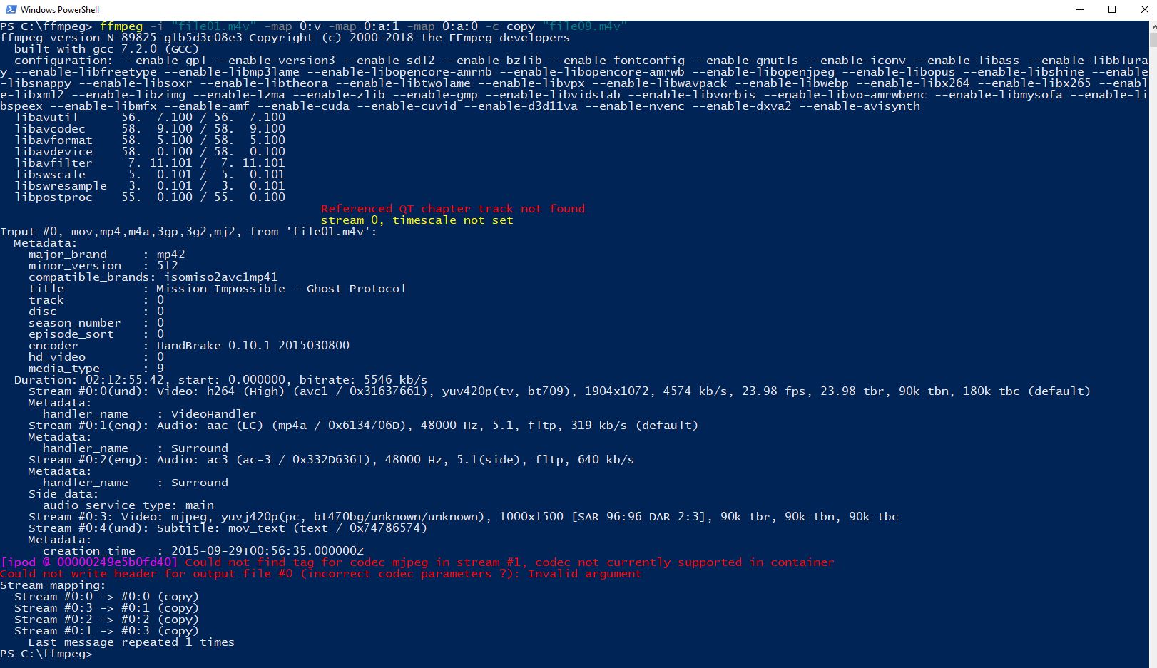

    I have ffmpeg installed. I (finally) figured out how to get it to "do stuff". However, I'm getting an error message when I try your suggestion above. Is there something about .m4v not playing nice in ffmpeg?
    Here's what I used:
    ffmpeg -i "file01.m4v" -map 0:v -map 0:a:1 -map 0:a:0 -c copy "file09.m4v"
    It returned with an error message and a 0kB file titled "file09.m4v"
    Error: "[ipod @ 00000249e5b0fd40] Could not find tag for codec mjpeg in stream #1, codec not currently supported in container
    Could not write header for output file #0 (incorrect codec parameters ?): Invalid argument"

  3. It seems ffmpeg cannot handle mjeg in mp4. Is that the cover art? If so copy without mjpeg:
    ffmpeg -i "file01.m4v" -map 0:v:0 -map 0:a:1 -map 0:a:0 -map 0:s:0 -c copy "file09.m4v"
    Then afterwards add cover again.
