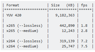

    Lossless compression is the opposite of "max. compression"; efficient compression is achieved by allowing a certain degree of loss.
    The compression ratio of lossless algorithms can't be tuned for a great range of speed vs. efficiency; if there are at all any options to change the behaviour, variation in results will be small.
    Depending on the video material (complexity and similarity), lossless compression ratios may typically be between 2:1 and 5:1 in relation to uncompressed YUV; lossy HEVC compression can achieve about 1000:1.

    I found on internet This:
    [Attachment 44480 - Click to enlarge]
    It seems to me done properly, but I can only guess. Check speed and size... In this case (lossless) encoding, x265 can benefit from x264 codec as special case
    I know it is hardly possible.
    Bernix

  29. Some quick tests for x264/x264/ff nvenc h264
    1920x1080 4:2:0 2582frames , outdoor scene, low motion, several crossfades, high quality src
    default settings for lossless
    x264 2.06GB
    x265 2.11GB
    ffmpeg nvenc h264 2.62GB
    x264 lossless doesn't use b-frames, but x265 does. NVEnc hevc doesn't use b-frames at all for lossy or lossless mode, but I can't test it here on this GPU
