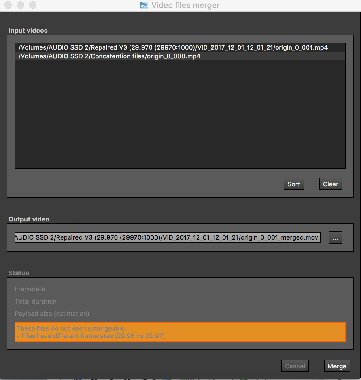

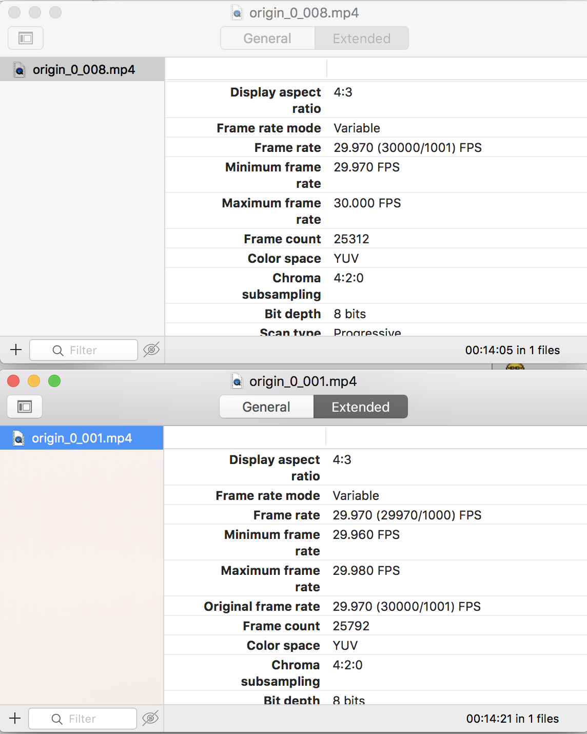

  6. We are basically dealing with a camera that has a variable framerate (dont ask), and it splits recordings into 14minute sections, we have found one of the files has been timestamped with the wrong FPS information. Hence the need to convert from 29970/1000 to 30000/1001. We have tried concatenation via AVP as we normally would, and using FFMPEG but we have issues with dropping frames etc. Basically a massive headache
    We have tried with a couple of different media info applications and they are reading the same info. See attached photo. The top window is a correct piece of content, and the bottom one is the problem file.
    Thanks for your help . Image

  10. You would think so, but when dropped into AVP to merge the files:
    [Attachment 44413 - Click to enlarge]
  11. There are 2 places framerate and timing information is kept , at the stream level as declared in the video stream header, and the container level as timecodes . You might have to address one or both
    The VFR display is likely it's jitter in the container timecodes. Look at the min/max values - very minimally variable - you can probably even treat them all (including the other clips) as CFR , if the other segments show similar degree of deviation

  16. Member Cornucopia's Avatar
    Unless MediaInfo is grossly inaccurate, it's not a question.
    Min 29.6. Max 29.8 isn't truly vfr, it's indicative of 29.97 that is inaccurately stored. I doubt there should even be jitter upon fix.
