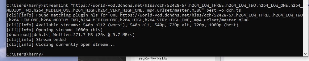

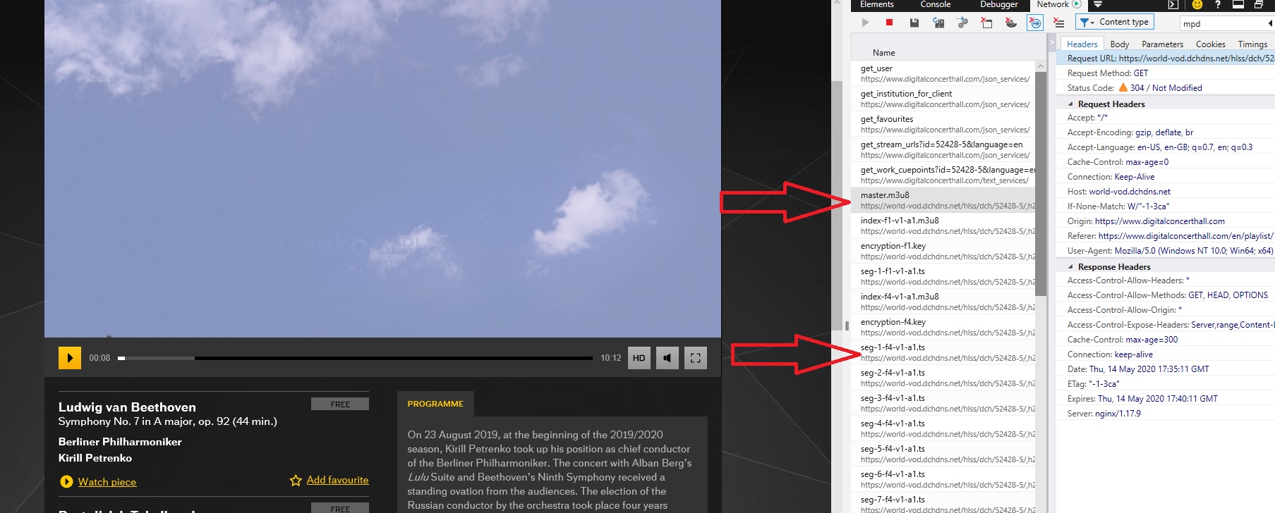

  7. Its easily downloadable with a Streamlink basic command. I don't know if your able to use the CLI and this app ? And the files ARE ts files : ) Notice the segments in the Network traffic ?
    [Attachment 53309 - Click to enlarge]
    I did a Filter URL for mpd but straightaway a 'master.m3u8' popped up telling us that the best quality available is 1080p. So with a simple Streamlink syntax I was able to download the 10 min Raw ts in 26 seconds.

    Here's the streamlink syntax to download the raw ts:
    streamlink "https://world-vod.dchdns.net/hlss/dch/52428-5/,h264_LOW_THREE,h264_LOW_TWO,h264_LOW_ONE,h264_MED IUM_TWO,h264_MEDIUM_ONE,h264_HIGH,h264_VERY_HIGH_O NE,.mp4.urlset/master.m3u8" best -o anyname.ts

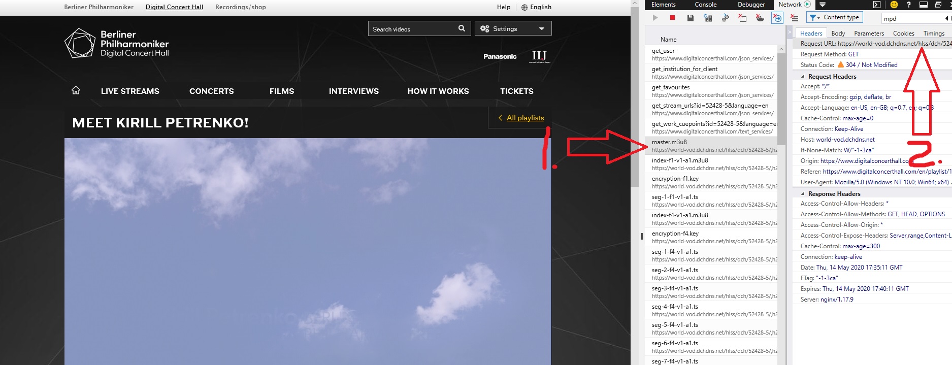

    To grab the master m3u8 with Edge browser:
    Click F12 key on keyboard for the DevTools
    Make sure VOD is playing
    Click the Network tab at top of DevTools box (and also the little green arrow if no traffic is showing)
    Locate and Left click on the entry at 1
    RIGHT click on the entry at 2 and select 'copy value'
