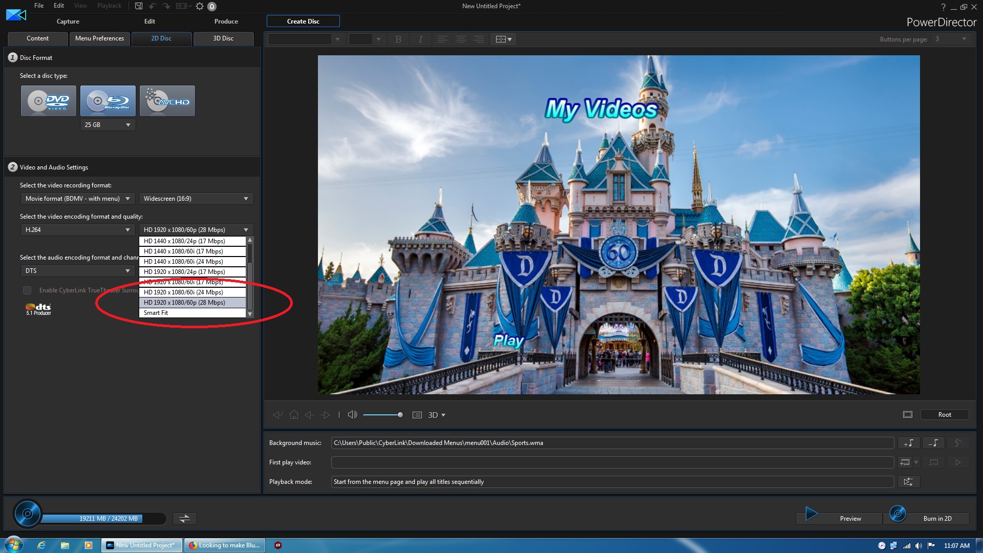

  18. Nope, not a typo. And your reply is very typical of why people are still in the dark about this.
    I repeat: The fact that 1080p60 is not a standard BluRay format hasn't been stopping hardware manufactourers from producing 1080p60-compliant players anyway. They have ignored the standard and produced it anyway, unofficially adding to the standard, and have been doing so for AT LEAST the last 5 years. It's time people woke up about this.
    Playstation 3 plays 1080p60 blurays.
    Playstation 4 plays 1080p60 blurays.
    Most all modern Samsung and Sony bluray players play 1080p60 blurays.
    CyberLink PowerDirector (all versions after 12 I believe) create 1080p60 blurays that play fine on these devices. See the included screen shot I just took from PowerDirector 16.
    You could be making and playing 1080p60 blurays - or you can sit there in disbelief, quoting old bluray standards, and NOT making or playing them.
  19. Originally Posted by Highwinder View Post
    You're mistaken
    It's AVCHD v2.0 spec , not a real blu-ray. Look at the bitrates (28MB/s) in your screenshot
    https://en.wikipedia.org/wiki/AVCHD#Specification_addendum_(AVCHD_2.0)
    FACT: The PS3 and 50% of BD players will stutter for 1080p59.94 with authored BD using 40Mb/s , even though they can might be able to play it as data disc or from USB. Some won't even play it back , it will say "invalid format" or something like that. Many but can play AVCHD2.0 28Mb/s discs . Not Blu-ray.

    Originally Posted by mr_lou View Post
    I just stumbled across this thread while googling for 1080p 60fps video for Blu-ray. Thought I'd share some related experience of mine.
    What Highwinder is saying is absolutely true, and I share his frustration very much when seeing wrong info here and there.
    When someone asks "Can I make a Blu-ray with 1080p60fps video?" the answer is of course "Yes you absolutely definitely can", and then you can add "- but it's not part of the official specs (from 15 years ago)".
    A while back I wanted to put my personal family video recordings on Blu-ray - but they were all recorded at 1080p@30fps - another non-standard Blu-ray. So I decided to investigate: I created a disc with a lot of 1080p@30fps video and another disc with a lot of 1080p@29,97fps.
    The results: Almost all players I tested on (more than 30 different old and new players), would play the 1080p@29,97fps fine.
    And only very few players refused to play the 1080p@30fps disc.
    So in my experience, 29,97fps is to prefer over 30fps. I'm guessing the same will apply to 59,94fps vs 60fps. So I will be using 59,94 fps in my upcoming project.
    EDIT: Looking at most replies in this thread I can see I better add this too: My discs are absolutely 100% compliant Blu-ray discs, with BDMV structure and even a Java Blu-ray Disc Xlet running as menu (which you can't do with AVCHD - so you know I'm not talking about AVCHD here). So there's no doubt that my test revealed that 99% of players had no problem playing a Blu-ray Disc with 1080p@29,97fps video.
    PowerDirector isn't the only way you can create a non-old-specs Blu-ray M2TS file. I'm doing all of my Blu-ray authoring on Linux, where I'm using tsMuxer to create any kind of stream I want. And I code my menus in Java. Blu-ray is awesome.
    Spreading the same misinformation across multiple threads does not make it true. Fact check: If a disc contains off-spec video, it can't legitimately be called a Blu-ray disc, even if it plays on many Blu-ray players.
    Also, I should point out that BDA-licensed authoring Blu-ray software is required to do verification which prevents creating a Blu-ray disc containing off-spec video in order to ensure the software's output is compatible with any Blu-ray player. 1080p@29.97fps video will pass verification if it is encoded as interlaced or uses the fake interlaced flag, which makes compliant with the Blu-ray spec. 1080p59.94 won't pass verification for Blu-ray if one is using licensed software. If the software allows AVCHD 2.0 authoring, as recent versions of PowerDVD do, someone could produce a 1080p59.94 AVCHD disc instead.
    tsMuxer is unlicensed authoring software which doesn't verify that video or audio is compliant in every respect with the Blu-ray spec. tsMuxer can be used to make off spec discs but makes no promise that the discs it creates will be playable on using every Blu-ray player. Playability is entirely dependent on the flexibility of the hardware in the Blu-ray player.
