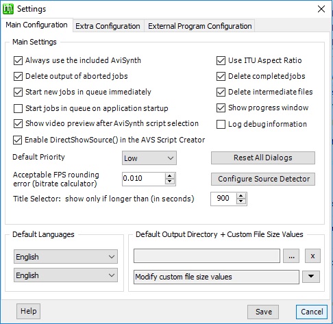

    Here's my settings:
    [Attachment 47118 - Click to enlarge]
    Please, help!

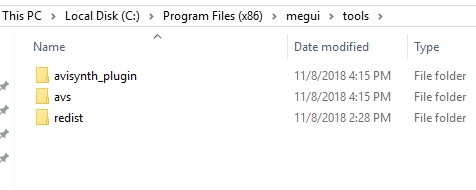

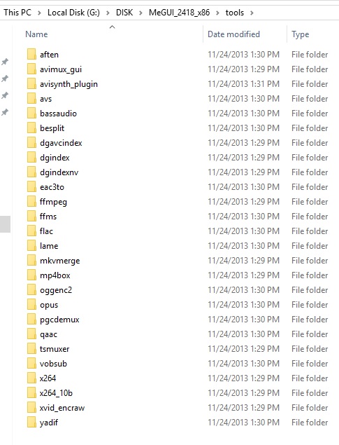

    Feb 2014
    Croatia
    Do I have to have all of this installed, like I had on the previous version of Megui (2418 x86) which, by the way worked like a charm (on Windows 8.1)?
    [Attachment 47119 - Click to enlarge]
    This is what it looks now:
    [Attachment 47120 - Click to enlarge]
