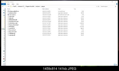

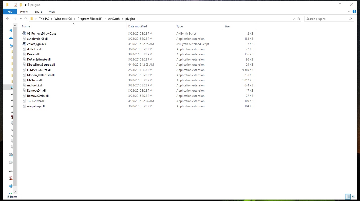

    Hmm. Ok yeah I was using *.* "All Files and not the way you mentioned sneaker. Thats odd why *.* "All Files doesnt give me an error even though the avs file type is included in it.. So ..now I do get an error code
    "Avisynth open failure:
    Load Plugin: unable to load "plugins/Depan.dll", Module not found.
    Install Missing Library?
    (C:\Program Files (x86)\AviSynth\scripts\01_E_Stabilisation_Only.avs ,
    line 54)
    Which is odd.. because I have Depan.dll in the plugins folder..
