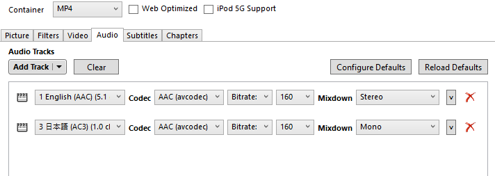

I have the MKV file with the following audio streams:
stream1: English 5.1 AAC
stream2: English 2.0 AAC
stream3: Japanese mono AC3

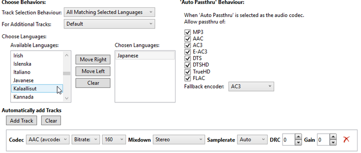

I'm trying to auto-select/add only the Japanese audio when I load the video. To achieve this, I've configured audio defaults for my custom preset to select Japanese only (see screenshot below).
My problem is that when I load my video, both the English 5.1 and the Japanese one were automatically included.

- If I removed all the auto-selected tracks and use "Add all remaining selected tracks", it will pick the Japanese audio stream only.
- On Track Selection Behavior, I've tried "First matching" and "All matching"
- I've changed the chosen language from Japanese to English. I then reopened the file and only the English 5.1 was added. The English stereo and Japanese audio were both ignored.
- On the "For additional tracks" setting (it's below Track selection behavior), I've tried all 3 and it doesn't make a difference.
- I've tried other videos with English 5.1 stream and Japanese stereo audio streams, both streams were selected.

https://forum.videohelp.com/images/imgfiles/ln6ZVTdg.png (setting audio defaults)
https://forum.videohelp.com/images/imgfiles/ufDiPCh.png (selected streams)

 EDIT:First means it choose first matched language you have selected if eng so eng5.1
 Try all and specify language to jpn. It should select all matched jpn taged track.
