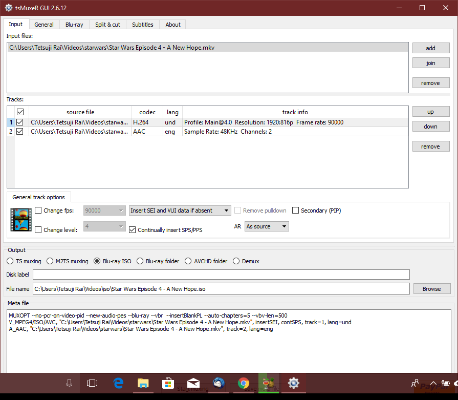

Title says it all. I was astonished with it. I am using Windows version. Sample screenshot is shown.
Please fix it or am I doing anything wrong?
Thanks in advance!
-Tetsuji Rai
[Attachment 44300 - Click to enlarge]

Tick "change fps" and choose "24000/1001". Then test if file is sync to the end. (If not, try other values, i.e. 24, 25 ...)

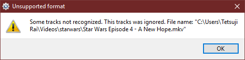

Thank you for the tip. I haven't seen the whole movie yet, but the subtitle track was removed. When tsMuxer loads the .mkv file, it says as the screenshot. I found this ignored track was subtitle. BTW this .mkv was made by Handbrake, combining .mp4 and .srt files. Which is to blame

Just change the fps in tsmuxer to 23.976.
Tsmuxer doesn't recognize streams that are not to spec in a given container. Technically srt will work in mp4 container but shouldn't be muxed within. Similarly if you mux TrueHD audio into a MKV tsmuxer will not like that either even though it plays fine. So to answer your question it's probably the srt that's the problem unless your audio stream is also other than AAC. -
Thank you tommy.
The audio track is AAC. That's the problem...then does avoiding AAC solve the problem? -
It depends on the container if mp4 then anything other than AAC will be a problem. For MKV it should be at least be AC3 but not TrueHD.That's the problem...then does avoiding AAC solve the problem?
There is high chance that video is or VFR or corrupted and this is how TSMuxer response (perhaps bug in code) - PCR clock is 90000Hz and as such tsmuxer may replace incorrect or not existing frame rate with smallest possible value (common way to deal with VFR video is repeat frames with highest possible frequency).
Thanks, tommy and pandy. I think I understood. I thought 90000Hz was higher than dvd audio sampling rate, so I was wondering why.
MKVExtract give me a video file with 90000 frame rate in TSMuxer
