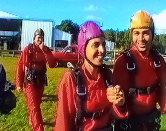

    I am in the process of capturing and enhancing some old HI8/VHS tapes in VirtualDub. Everything is going pretty well, but with one video I am encountering some color problems. Please see red colors below. Is there a simple filter to do something about this?

  3. Short answer: Colormill.
    As for your image, it is WAY too saturated. Before you start correcting colors, take care of that. It looks like you used a capture card which has proc amp settings. If so, play around with the adjustments before you do any more captures and see if you can correct the problem there.
    Actually, if you tell us what hardware you are using (name/model of VCR; capture card; post production software) the people here might be able to give even more advice.

    it is oversaturated, and color correction is needed, but I think main question is because there is ghost or how to say (shifted red channel) to left. Sky sees also unnaturally.

    With NTSC video, reds often "bloom," especially when you oversaturate. You lucky people in PAL-land don't have this problem. My guess is that if he figures out how to not capture with so much saturation, the redbloom/offset will take care of itself.
  6. I was thinking there might be a problem with blending of the chroma channels. Like when interlaced YV12 is treated as progressive YV12, a common problem with VirtualDub. That's why I asked for a video sample.

    Doesn't look like it's going pretty well to me. You've given no info about what you're using for capture or how you're controlling input levels (which your image says you obviously aren't doing). What do you expect us to do with a sample you've already enhanced by deinterlacing and reprocessing? Are you actually capturing at 564x447 ? That's not an even-numbered frame dimension.
    Ever heard of a histogram or a vectorscope? VirtualDub has a nice one that can tell you a lot if you learn how to use it.

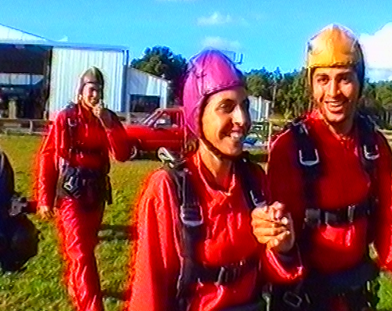

  21. Video Restorer lordsmurf's Avatar
    To add:
    The original video has color bleeding.
    Just do a chroma offset in Avisynth.
    And then some color work in an NLE or VirtualDub Colormill.
    The bigger issue is that the original capture is not very good.
    Something like this is far more realistic to the scene:
