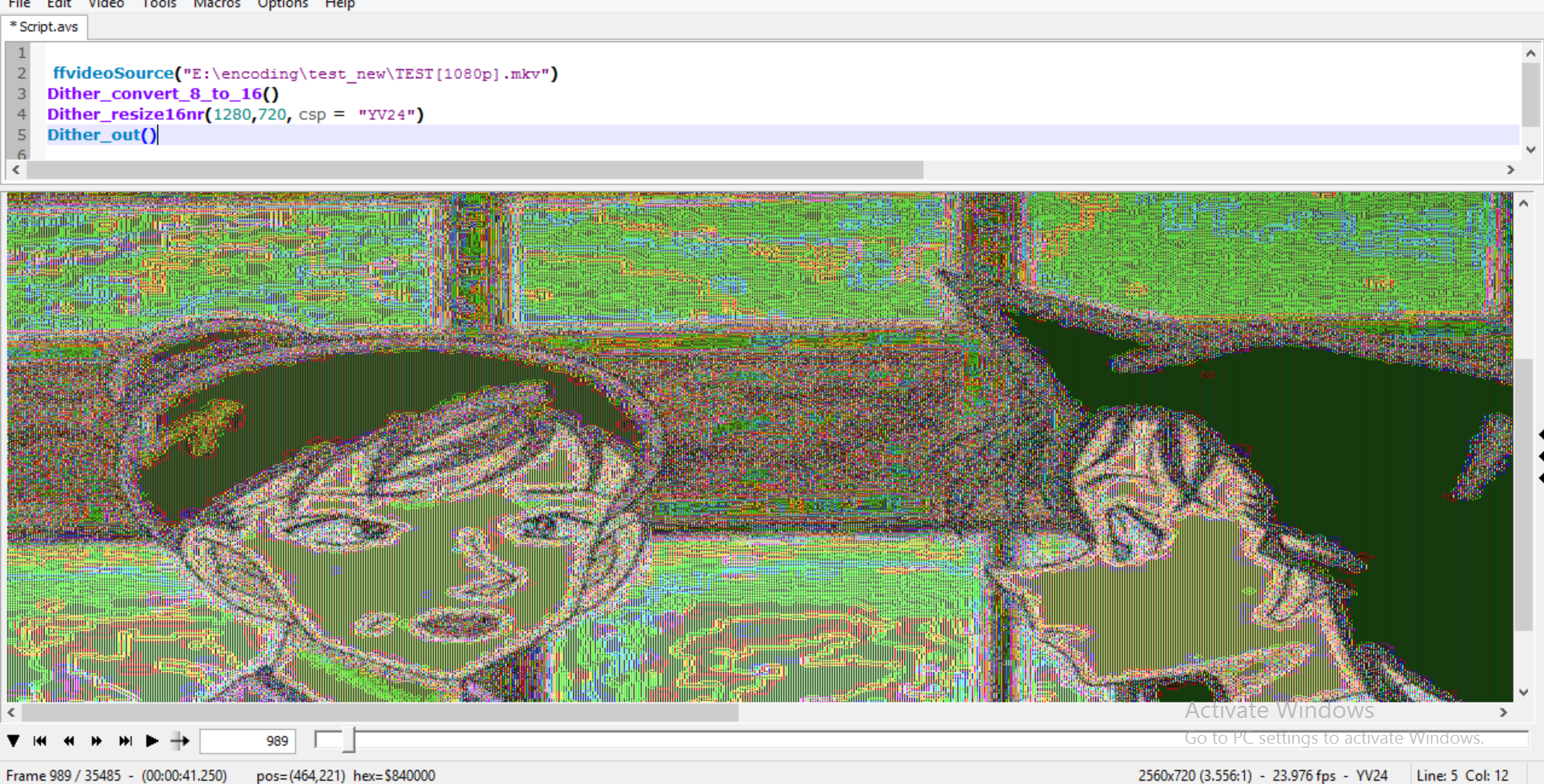

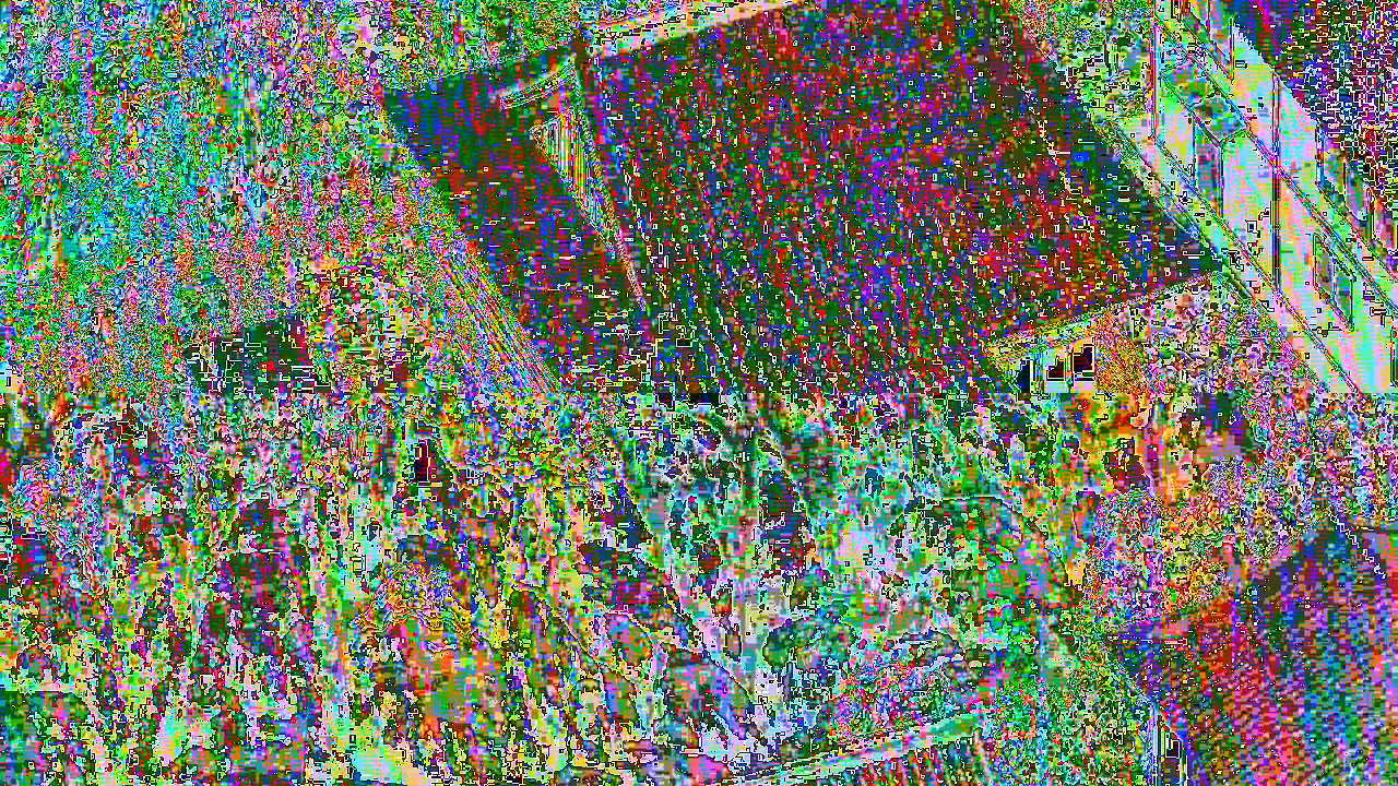

    I just start some test with "Dither_convert_8_to_16" filter, but I got problem when i used Dither_out filter
    here is my code:
    ffvideoSource("E:\encoding\test_new\TEST[1080p].mkv")
    Dither_convert_8_to_16()
    Dither_resize16nr(1280,720, csp =  "YV24")
    Dither_out()
    the video resolution become 2560x720 .
    any help plz
    thanx.

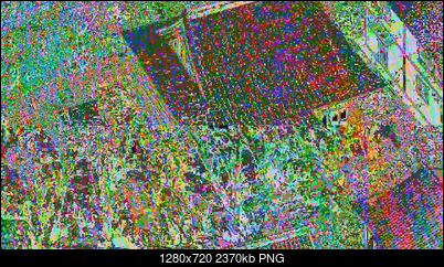

  3. This is completely normal. AviSynth (not AviSynth+) cannot natively handle >8 bit so if you view the script it will look like this with double width (basically it converts the 16 bits into 8+8 bits - there is also stacked variant). You just have to tell your encoder that input is actually 16 bit.
    E.g.:
    avs2pipemod -rawvideo "script.avs" | x264 - --demuxer raw --input-depth 16 --input-res 1280x720 --fps 24000/1001 -o "output.264"
    You can read about it in the Dither documentation. It's very good. (But not developed anymore AFAIK. People have switched to AviSynth+ or VapourSynth.)

  5. Are you encoding 10bit444 ? You have to use a 10bit x264 binary and specify --input-csp i444 --output-csp i444
    (If not 444 then why "YV24" in your script ?)
  6. Two possible problems:
    A. As poisondeathray saw I missed the csp = "YV24". Then the command is a bit different:
    avs2pipemod -rawvideo "script.avs" | x264 - --demuxer raw --input-depth 16 --output-depth 10 --input-csp i444 --output-csp i444 --input-res 1280x720 --fps 24000/1001 -o "output.264"
    B. You are using AviSynth+ with ffms2. If ffms2 is recent and your source is not 8 bit it may be in non-8-bit-AviSynth+ format. But Dither package doesn't understand those and treats input like 8 bit. Then you get problems.

  8. 1. Use avs2pipemod, not avs2yuv.
    2. Use the commands I used, don't change them however you like.
    If it still does not work show what script and command you are using now. There have been several examples and now I don't know what you are using right now.

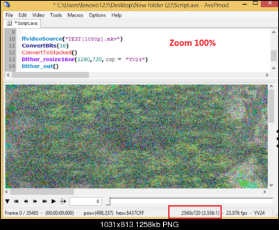

    >> Video resolution become 2560x720
    bat:
    avs2pipemod.exe -y4mp "script.avs" | x26410b.exe - --demuxer y4m --input-depth 16 --input-res 1280x720 --output-csp i444 --fps 24000/1001 -o "output.264"
    the encoder couldn't encode the input file only 1 frame

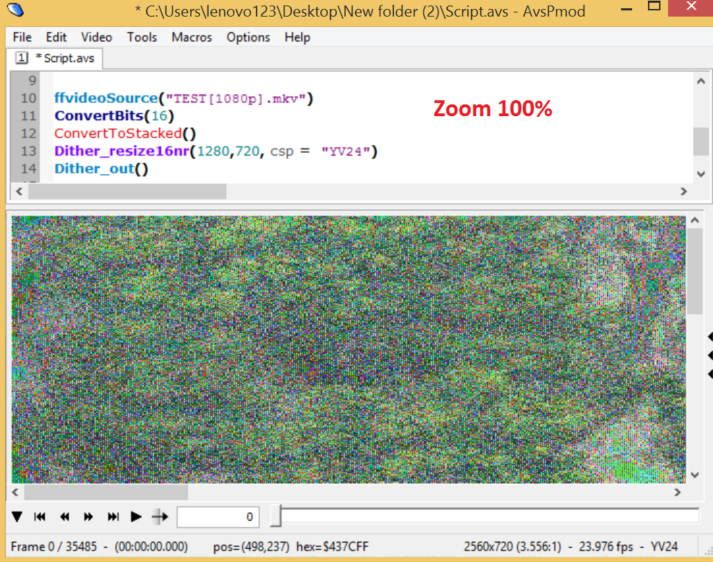

    bat:
    avs2pipemod.exe -y4mp "script.avs" | x264-r2893-b00bcaf.exe - --demuxer y4m --input-res 1280x720 --output-depth 10 --output-csp i444 -o "output.264"
    result: attachment

  14. Don't mix and match commandlines. Only raw requires specifying parameters, y4m has header information and should convey info like resolution, frame rate
    It works for me with komisar's old 10bit x264 . I tested x86 . Mine is renamed to "x264k32_10.exe"
    avs2pipemod -rawvideo input.avs | x264k32_10.exe --demuxer raw --input-depth 16 --input-res 1280x720 --fps 24 --input-csp i444 --output-csp i444 -o output.mp4 -
    input.mp4 was a "regular" 8bit AVC 1920x1080 24fps (not 23.976 like yours, so you would use --fps 24000/1001) . ffms2 would have worked too

  15. Thank you guys, but the problem still exist with avs script
    this command help now to encode 1280x720 video, but the major problem still a same before & after encoding
    avs2pipemod.exe -rawvideo "script.avs" | x264-r2893-b00bcaf.exe - --demuxer raw --input-res 1280x720 --input-depth 10 --output-depth 10 --output-csp i444 -o "output.264"-

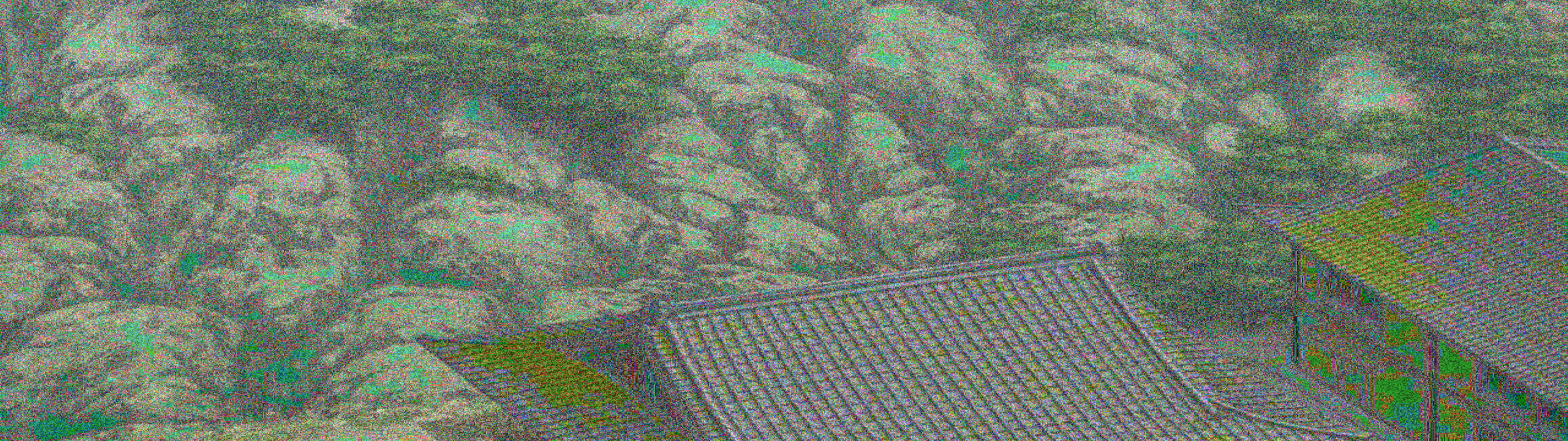

    after

  17. How are you decoding the output file ?
    Cut a piece of your mkv with mkvtoolnix and upload the sample here

  19. Originally Posted by alkoon View Post
    --input-csp i444 --input-depth 16 (--fps 24000/1001)
  20. Thank very much guys (poisondeathray & sneaker)

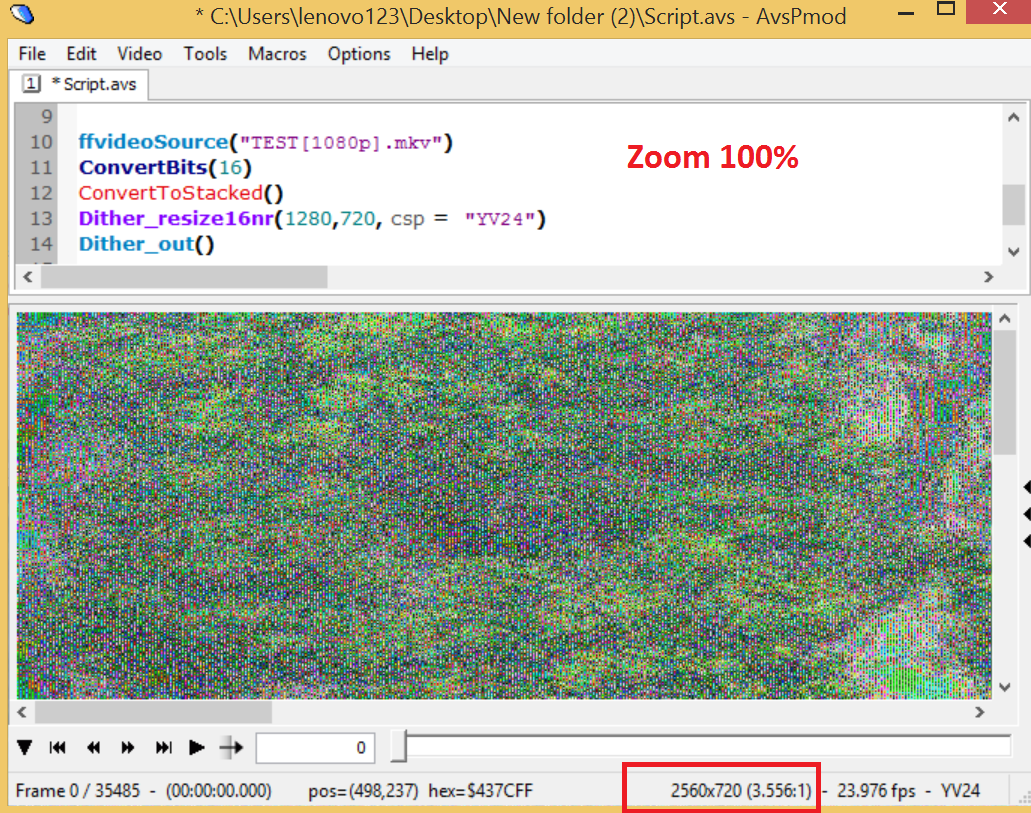

    but I have one more question, this is what the input info should be, right?
    YUV-444-planar-8bit... etc.
  21. That is the native AviSynth format as seen by avs2pipemod. 2560x720 at 8 bit. But we tricked by actually using it as 1280x720 16 bit and just tell x264 that's what coming. So everything is correct.
