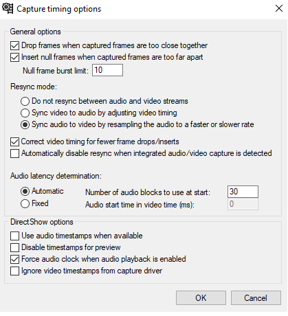

    Can you tell me what I can adjust in de timing settings? My setting are as below:
    [Attachment 44216 - Click to enlarge]
  5. Try enabling "Do not resync between audio and video streams".
    I don't know of anyone who uses the settings you've shown. Settings also depend on the capture device, for which you've given us zero information. virtualdub capture advanced settings guide.
