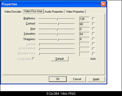

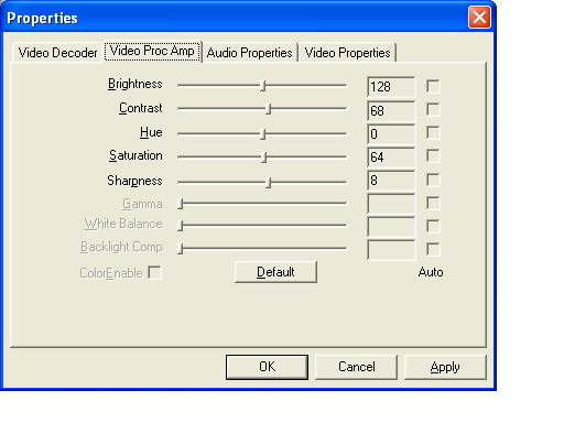

  5. So there's not "auto" column next to the other proc amp settings? Here's a typical proc amp dialog in Windows with the auto column:
    If that's the case maybe the VC500 always has the AGC enabled. Start capturing a few seconds earlier and trim the unwanted frames away.

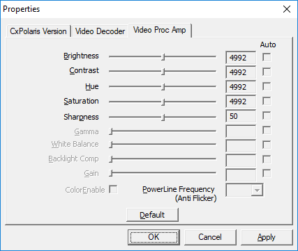

  6. Image
    [Attachment 44199 - Click to enlarge]
    The auto's are all greyed out.
    I tried capturing several minutes before, but it doesn't seem to lower it until shortly after a clip goes above 100 IRE.
