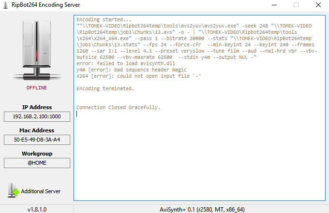

    Could someone that was able to master distributed encoding with Ripbot264 please be so kind to guide me on how to set this up properly on two machines - one running Win 7 64 and the other Win 10 64? I tried researching it but couldn't find any current information except for one incomplete Youtube video that is no help and another guide that supposedly is great but unfortunately the link no longer works - http://www.thehtpc.net/htpc-tips-and...uted-encoding/
    Thank you in advance, Safe Holidays and Happy New Year!!
  2. What part of that video you do not understand?
  3. Hi Atak_Snajpera,
    Thank you for responding and sorry for the delayed response but I wanted to analyze the tutorial video again and give things a try before responding. I think I understand it now but unfortunately it doesn't appear to be working for me. Here is my setup and what I did.
    The setup are two machines:
    1) running Win 7 64 and already encoded a video on this machine with Ripbot264 without issues
    2) running Win 10 64, successfully connected with machine 1 over a network and installed the necessary pre-requisites: Avisynth+ MT, FFDshow 64 and Haali Matroska
    Splitter. Ripbotx264 launches successfully on this machine.
    Here is what I tried:
    1) launched Ripbot264 and in the GUI settings checked the "Distributed Encoding" check box. In the Tab where there are IP fields I entered the correct IP with port for the Win 10 machine
    2) I added a job and applied desired encoding settings
    3) On the secondary Win 10 machine I launched the Ripbot264 server exe only
    4) On primary Win 7 machine I hit start. The client launches successfully and begins to copy files to shared folder followed by indexing.
    5) I can see Queues/chunks and the encoding starts on the primary machine but when I hit online for Server 2 in client it tries to connect and then goes offline.
    6) By looking at the status on the Server 2 machine I see the following errors (see image below) and can't figure out what's wrong.
    [Attachment 44213 - Click to enlarge]
    Thank you in advance.
  4. Hi there,
    Thank you for your response and actually I installed the FFDshow 32 bit as I read in a post somewhere that Ripbot supposedly is not compatible with the 64 bit version and also installed the C++ binary which fixed the problem. I just didn't know which really did the trick but now I know.
