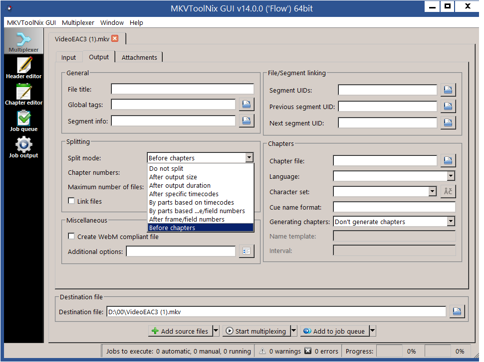

You didn't use "Before chapters" as splitting mode?
[Attachment 44182 - Click to enlarge] -
He's talking about "Ordered Chapters". It's useless to try with simple splitting. The only way is to first split and then join (like jagabo said). And of course you may run into the usual splitting/joining complications (different headers, OpenGOP, lack of keyframes ...)
