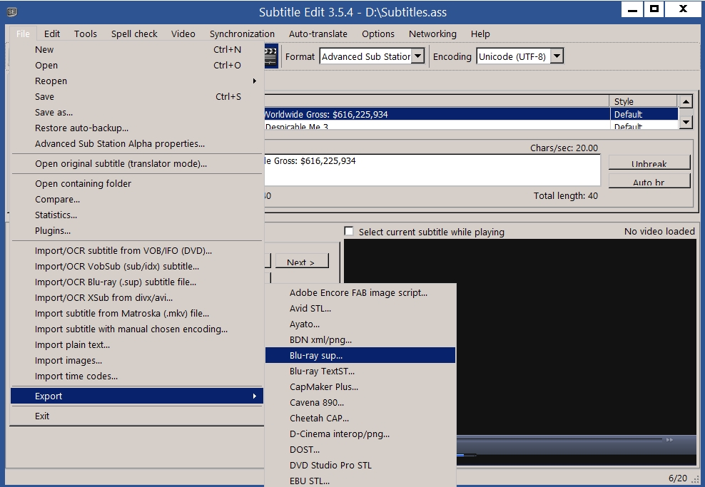

Subtitle Edit can (File ->) Export -> Blu-ray sup with a Preview. -

"Subtitle Edit can (File ->) Export -> Blu-ray sup with a Preview."
But according to description you can't import text based subtitles into Subtitle Edit and convert to sup.
EDIT: I tried running it and the software is actually shot entirely. When hitting the Start it just gives off a sound like when it's done building the subtitle without even opening the cmd window where you would normally see it processing lines.Last edited by tommy2010; 27th Dec 2017 at 19:13. Reason: More info

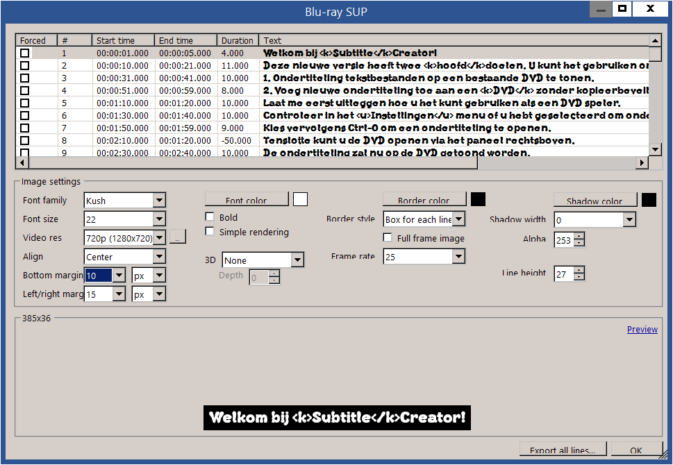

Oh yes it does. Compared to EasySUP it lacks support for some tags in ass subtitles but since you're working with .srt this shouldn't be a problem.But according to description you can't import text based subtitles into Subtitle Edit and convert to sup.
[Attachment 44180 - Click to enlarge] -

txt2sup is for DVD. You can convert those with BDSup2Sub to BD sup.
For .srt you can set a bottom margen.Does Subtitle Edit allow for subtitle positioning of any kind at least a x amount of pixels from bottom
[Attachment 44190 - Click to enlarge] -
