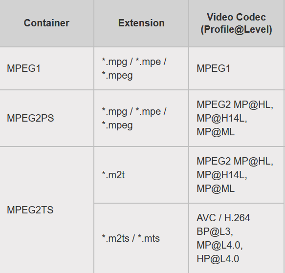

	Here I started https://www.sony.co.uk/electronics/support/televisions-projectors-lcd-tvs/kdl-55w829b#manuals
 From here https://www.sony.co.uk/electronics/support/res/manuals/Z012/Z012721111.PDF
 I got here http://pdf.crse.com/manuals/14HE468112/EN/codeclist.html#10
 And it seems 4.2 is high if I'm not wrong. Just check last link. But I think it should refuse this file and don't try to plays it.

 The media info you posted there is level 4.2 If DVD has same level, this can be source of your problems. It supports Mpeg1, TS and PS. And have you played DVD through DVD player of stored on USB? Because DVD player can have different limitation. And Mpeg2PS doesn't support aac, which is obvious.
 [Attachment 44155 - Click to enlarge]Last edited by Bernix; 26th Dec 2017 at 11:46. Reason: Underlined text
