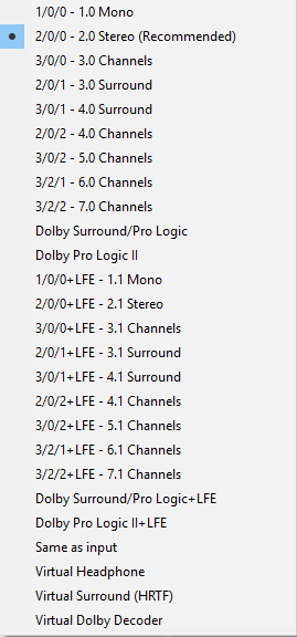

    Don't know how other software, but you should be able setting up it in your audio driver. But not all audio is 2/0/1 or similar.
    You can also set Output speakers to 2/0/1 in potplayer. As I mentioned earlier don't know other players. If you want try it, rmb on screen then audio - output speakers and here 2/0/1 aka 3.0 surround.
    [Attachment 44124 - Click to enlarge]
    But remember most common is stereo and 5.1 or 7.1, can imagine how will stereo sound looks on your system.

    I hear no significant difference of the sub-woofer volume, by choosing the different output speakers options (including 2/0/1) in PotPlayer. How do I use the equalizer to boost the bass?
    Bernix
    Bernix
    Isn't 2.0.0+LFE the right decision for 2.1? I'm not familiar anymore with PotPlayer, I switched to MPC-BE long time ago

    None of the choices in Potplayer seemed to make any difference for my 2.1 speakers. Media Player Classic is what I am using too.
